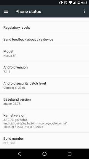

Got it. As far as I know, I am running 7.1.1 beta, correct?

Yes. Beta builds start with NP in the build number.
