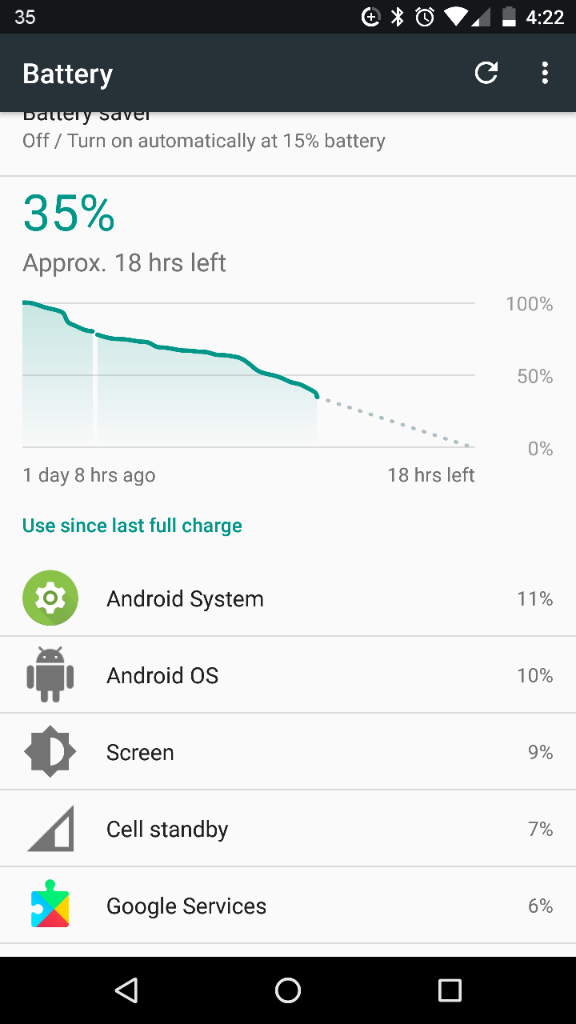

I am noticing that my 6p seems to drain the battery more than marshmallow. Doze seems to be working correctly but the battery seems to drain just sitting. Does this look correct?
mine has been averaging around 7 hours with only 1.5 hours of screen on time so I would say yours is amazing. I used to get over 14 hours and only thing that has changed is getting nougat.
It's really hard to tell since the percentages shown in the screenshot don't give specific information (ex. number of hours/minutes of screen on time). If you use a tool like GSam (mentioned by a previous poster) you can look at more specific data, particularly if you enable the non-root workaround that allows you to see a breakdown of specific app usage.
With all of that said, a good test if you want to know if Doze is doing its job during inactivity would be to fully charge the device before you go to bed and leave it off the charger while you sleep. When you wake up hopefully you'll see 4% or less of usage for an 8 hour period.
You can also look at the "History details" screen (press the graph in the screen you showed us) to see how your cellular signal is and how the Awake time compares to the Screen on time (ideally they'd be very similar).
