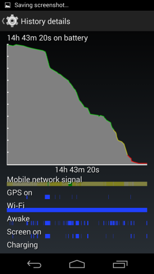

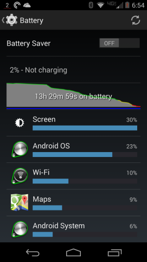

Welcome to Android Central! A good start would be to post your battery stats screen (which shows a breakdown of what apps and services are using what percentage of battery), and the Cell Standby screen (which shows you the % time without signal, since poor cell signal can eat up battery life).
To add to B. Diddy's post, a screenshot of the graph is helpful as well.

Thanks for the responses. I am not sure if this is the correct way to post the screenshots, but here's what I took when it was at 2%.
Do you normally leave your WiFi on all the time? I also noticed a not so wonderful cell signal. Is that normal as well?

The signal also is bad which I drains it faster. Along with the Bluetooth and any thing else.
My best guess with limited info (like what apps you have) is that it's due to 1) partial wakelocks (lots of awake time with your screen off) 2) Poor signal.
Thanks for the tips / feedback. I ended up uninstalling a bunch of apps and cleaning up the phone. It seems better now so it must have been something I had put on... My initial hunch is it was an app called "Settings Extensions" that was causing some excess battery usage...
I would also watch your Android OS percentage. That's an indicator of a rogue app using up your battery. Somewhere in the 17- 20% range depending on your usage. GPS will also use up the daily battery cycle if you have it on high accuracy.
