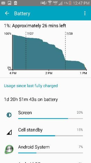

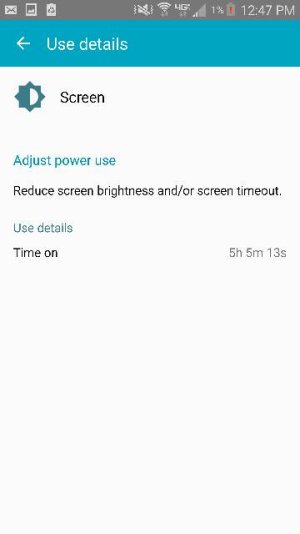

Usage patterns vary. I'm running a Note 4 for comparison (an older less power efficient version of your phone) and BARELY squeezed out 5 hours from a 44 hour session. You should definitely be able to pull more than I do, depending on use.
I use my phone for texting, forum browsing and listening to music for the most part.
I know it's different phones, but the newer phone should be able to squeeze more than an older phone because of all the enhancements under similar usage conditions.

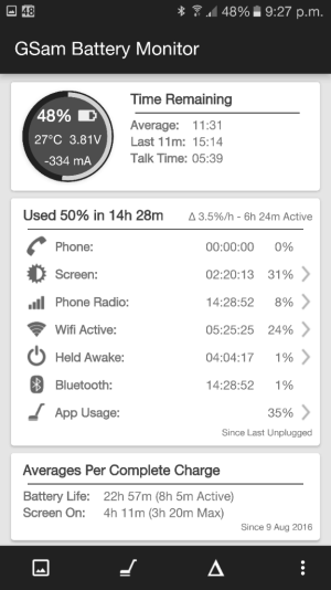

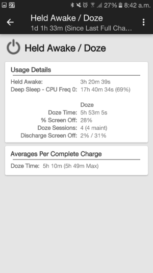

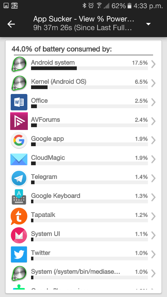

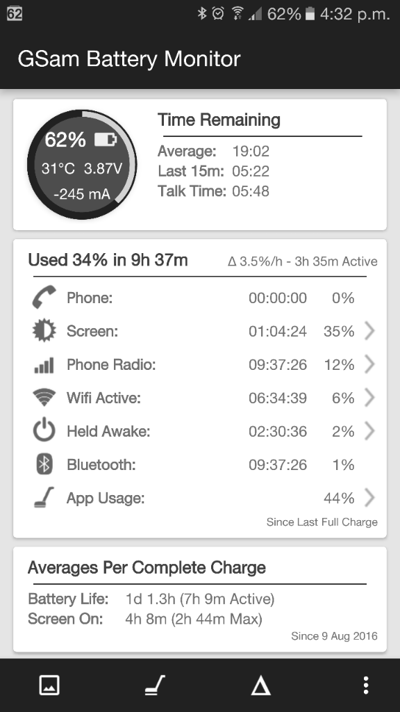

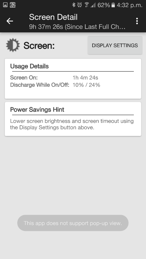

Ok, so here are some screen shots from Gsam. Can someone let me know what they think because I've never used it before but I can see some really odd stuff straight off the bat.
Screen drain, more has drained with the screen off than on!? Am I reading that wrong!?
App usage, Microsoft Word is high on the list yet I've not opened or used it this week!

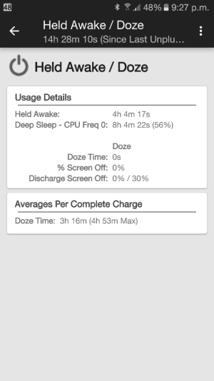

Doze, looks like the phone isn't dozing at all? Or am I reading wrong?
Many thanks for your help
Those stats look fine to me. 62% left after 9+ looks good to me.

Anyway, it seems your phone has been kept awake for an abnormally long time.
For comparison. My phone was kept awake for 45 minutes out of 8 hours.

Yeah that's what I thought, unfortunately I forgot to screen shot the stats before I went to bed last night. I got up and plugged it in this morning and the stats have been reset.
It does appear to be staying awake and the doze time is next to nothing which is poor considering how good the feature is supposed to be.
Here are some screen shots of a full day, whilst the battery does appear to be good with no real concern about it not lasting all day, I am concerned about the amount of time it's being held awake. It doesn't seem to be entering doze at all.

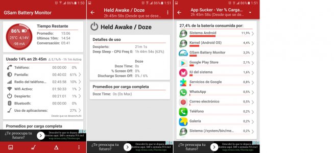

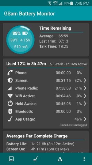

Have you found any ways to improve this? I'm on a similar situation, but way worse. I'm sitting at around 5% batter / hour with basically doing nothing (you can see that on the app list)
My samsung is the exynos duos variant (SM-G930FD). Sorry about the spanish on the screenshot :D

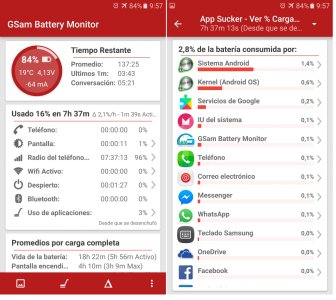

This is very strange, even with airplane mode, and everything disabled, the usage is of over 16% after 8hs idle!
What's even worse, is that all the usage comes from the celular network, which shouldn't be happening with airplane mode, should it? Look at the below screenshot.
I have done that already, both the apps cache and the partition cache from the recovery menu. I'm starting to think that the app is just giving me wrong values because it just doesn't make sense to have the phone radio use all the battery on plane mode and without wifi. I have changed some settings in the app and will try again this night. Although even if the app is reporting incorrect values, the fact that I'm losing 16% of battery in just 8hs and completely idle is just crazy, when I see people reporting 2 or 3% for the same.
Note that this is a stock android, nothing changed, bought a week ago and the S7 Exynos and Duos variant.
