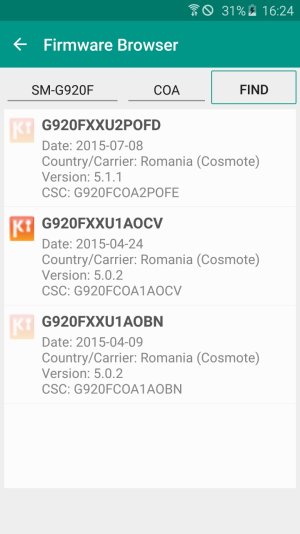

Screenshot_2015-07-23-16-24-01.jpg the same one i got on...one of the 5.0.2 version i had on ( or i suppose since the csc matches my baseban version)
View attachment 188304 the same one i got on...one of the 5.0.2 version i had on ( or i suppose since the csc matches my baseban version)
First, check the CSC Codes and Firmware tabs, the CSC tab will tell you the CSC you originally had and if the one you installed is different it will show you both, if it only shows one, so the Original and Actual are the same then you installed the correct region one.
Just check your firmware (PDA) and baseband, the one you should be using should match the original PDA in your phone, if that was the one you used, then I don't know, try flashing it again, just wipe cache partition and wipe data/factory reset after the flash.

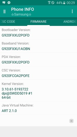

Screenshot_2015-07-24-00-29-09.jpg here is it ...the pda matches the 5.0.2 version.....now my problem is that i cannot make odin work anymore . even the first time i used it i got error and bircked the soft ( the currently one i got )...i had to extract the recovery from the md5 and flash it separately after ( odin was failing at hidden.img )
View attachment 188397 here is it ...the pda matches the 5.0.2 version.....now my problem is that i cannot make odin work anymore . even the first time i used it i got error and bircked the soft ( the currently one i got )...i had to extract the recovery from the md5 and flash it separately after ( odin was failing at hidden.img )
Do you have latest Odin version, 3.10.6? If yes, man sorry but I really don't know what else to tell you, maybe to find a way to flash via ADB if it still even possible, do a search about if it's possible and what to do.
