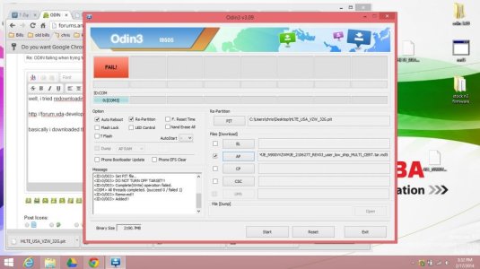

hey there everyone!! i havent been around for a while. i'm trying to root my MJE SM-N900V on verizon. i'm using the following turorial:
How to Root Verizon Galaxy Note 3! | GalaxyNote3Root.com
when i start odin i get a fail. here is a screen shot of what is happening.
http://i1110.photobucket.com/albums/h445/chriscw81/rootfail.jpg

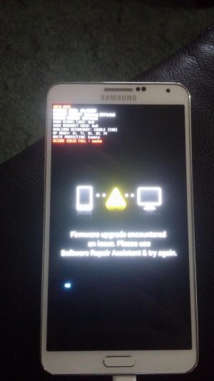

after the failure the phone is at the screen showing a phone, triangle with an ! in it, and a computer screen. it is saying "FIRMWARE UPGRADE ENCOUNTERED AN ISSUE. PLEASE USE SOFTWARE REPAIR ASSISTANT & TRY AGAIN."

well. i closed odin and reopened it as administrator. then i unchecked f. reset time. no joy. still getting the same error and the process is still failing. should i have "re-partition" checked?
No. That can brick your phone :eek:

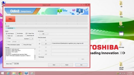

well, i tried redownloading and md5ing and retrying with not luck. i even tried flashing back to stock by following the instructions here:
[GUIDE] VZW Note III Edition[Return to Stock or recover from a Soft Brick and More] - xda-developers
basically i downloaded the stock flash and the .pit file then tried reflashing. it almost immediately failed.
here is what it looks like when if failed:
any ideas? this is driving me nuts

hmmm not sure why pic isnt showing up for you but here is a direct link to it:
fail2.jpg Photo by chriscw81 | Photobucket
i may try to use kies
so i switched to the usb cable that came with it and now it seems to be working(i thought i read in multiple places to not used the cable that came with the phone). i'm flashing back to stock now. hopefully i can get it back up and running so i can eventually get this baby rooted.
