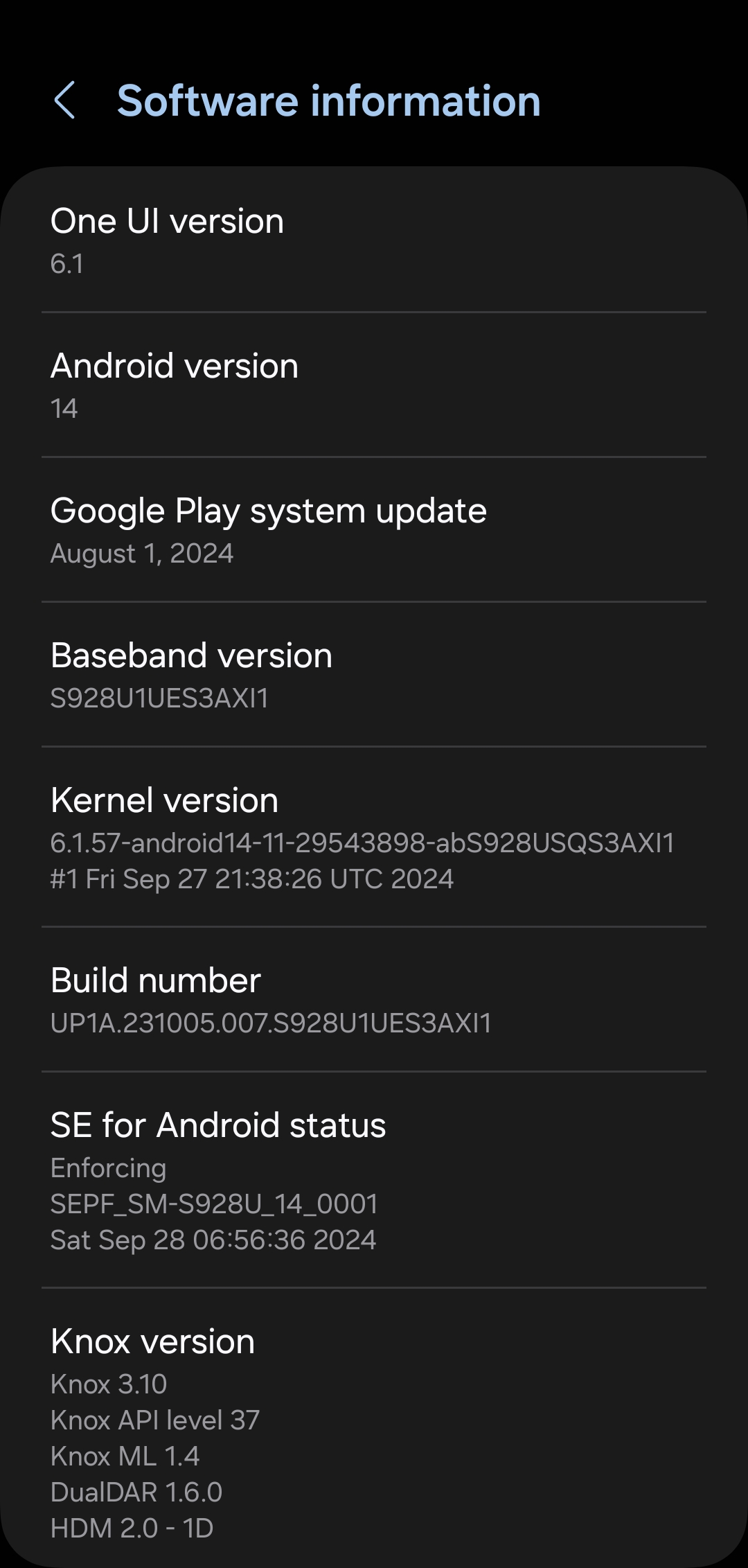

Just wanted to confirm, not play store update but Google Play system update which is in settings>about phone>software>scroll to play system update , you can tap to manually update
Screen shot
Yes, that is what I meant to say. Play system update in Software info has been applied immediately following OS update. Sorry for the confusion.
