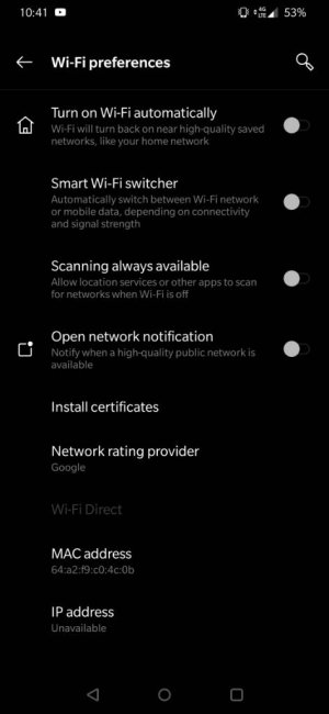

Check you settings in wifi it my be set to best connection if your wifi network is not as good as your mobile your phone will set to mobile....check your wifi settings on you phone almost positive its that
I've played with all of those with no luck, so I am now trying battery settings.
Adaptive Battery might be the culprit. I'll keep tinkering. I wish I didn't have work during the day so I could really dig into this. I'm enjoying learning about the phone and settings through this though.

I went into battery settings > battery optimization > options (three dots in the corner) > advanced optimization and then turned off "Sleep standby optimization." seems to have solved the problem on my end.
