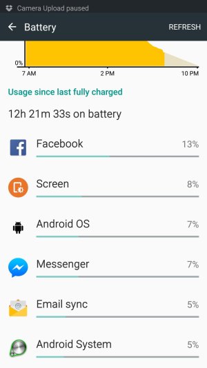

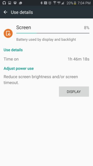

How do I get better battery life? This was a pretty normal day:
7AM - off car charger - 100%
7PM - Home, no charging in between, - 20%
Screen on was less than 2 hours.
Mostly just checking Facebook or news during the day.
1hr bluetooth music streaming in car in afternoon, maybe 30 minutes of GPS Google Maps, no texting really...
This typical scenario in an iPhone 6 Plus would probably leave me at 50% battery life instead of 20%, so far the iPhone seems to get 50% better battery life... so how are some of you guys getting good battery life?

I would tweak Facebook settings if I were you. There's absolutely no reason Facebook should ever use more power than the screen itself. You can turn off Facebook auto-refresh in the background which is probably what's eating up your battery. It refreshes your News Feed as soon as you open up the app, there's no reason to have it refreshing in the background when your phone is locked.
That's pretty much the only thing I can think of, otherwise everything else seems normal. GPS is a real battery killer, and the battery on the Edge+ is... well, it's no iPhone 6 plus let's put it that way. Apple runs a very tight ship when it comes to background tasks, in exchange for Android's customization you get optimization.

Your Facebook and messenger are your culprits I'm sure that's chewing through your battery, kill off all those unnecessary background updating and notifications you'll see a remarkable difference, when you open the app it'll update so don't worry about it not. Do that for all your apps that you don't necessarily need continuous notifications for, you'll find that in each apps settings. Also turn off location history and put your screen brightness to about 50 you'll find that should be plenty bright for indoor and most outdoor use, and disable and unneeded Samsung or carrier bloat apps, do all that and I'm sure your screen on time will double.
Thanks for the suggestions, but how do I do this? I don't the see the setting in the Facebook App or Messenger App to restrict background activity.
Go to your phone settings > Connections > Data Usage > Background Data
Here you will see a list of pretty much all your installed apps and each has a toggle of whether they should be allowed to be connected in the background or not. Simply toggle the ones you don't want running in the background. I would recommend toggling off Facebook but not Facebook messenger (if you use it actively) as messengers and email services do require background data in order to receive push notifications.

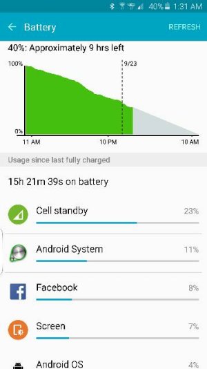

Mine today
What? How did you get almost 6 hours of SOT and have it only use 6% battery? Did you have it on the lowest possible brightness? lol
I use it on about 25% to 30% inside the house and on auto when outside.
