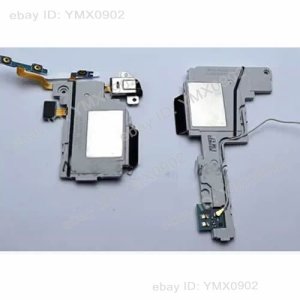

Factory reset will not fix a broken earjack. It comes with left speaker, power and volume button as assembly set.
It't not difficult to change as you only need to remover the rear cover and one screw to take out the whole speaker set. Sending for repair is not necessary as it takes at least 7-10 days to get it fix for a simple repair
Loud Speaker Ringer Power Volume Flex for Samsung Galaxy Tab Pro 10 1 T520 | eBay
This video for replace battery, but just look to see how it's easy to replace the left speaker which is not in the video.
When the back is facing you, left speaker will be on the right.
