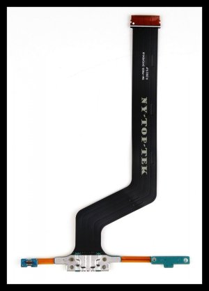

Check the bottom of your USB flex cable, there is a small cable on the left side connected to it, make sure the connection is not loose.
This cable will light up the Option and Back button.
The one on the left side, it will connect to your HOME , Option, and Back leds
Make sure your USB Flex Cable inserted correctly, the line on cable and main board should be aligned.
Not fully inserted Usb flex cable may cause a short.
The lower parts of the cable are covered by something. Do I have to open it? I tried reinserting the flex cable but it did not work.

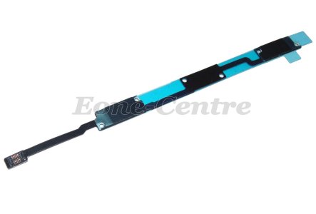

Thank you so much for your help but, unfortunately, it still is broken. I sent it to a Samsung service center and they said that there has been water damage to the Menu capacitive button. They said that the entire LCD screen must replaced to fix it. Can I trust their recommendation? Do I follow it?
If "MENU" button is actually damaged as its a captive function of digitizer screen then yes digitizer/LCD screen has to be replaced and its a factory bonded unit of digitizer screen and LDC display.......
Dale
Actually you only need to replace the Option, and Back flex cable but the entire LCD and touchscreen must be remove from the frame to get this flex cable. The LCD assembly is expensive so if your tablet is OK, no need to change the LCD assembly..
Watch this video so you can see how to get to that Option and Back flex cable
https://www.youtube.com/watch?v=Nn9OUhc99TY
Oh ok. I see. I guess I'll just have to look for a place that will replace the cable only. Thank you so much!
Actually it can be fixed by yourself, open the rear case assembly from the front, not from the back as you did. Use a brush and wiping alcohol to clean the flex connector where it connected to USB flex cable or both depending where is the water or liquid residues causing a short.
Try to power on and testing the Option and Back button, if it's still not working, just disconnect it from USB flex cable. Your buttons still function but no light up when touch them.
