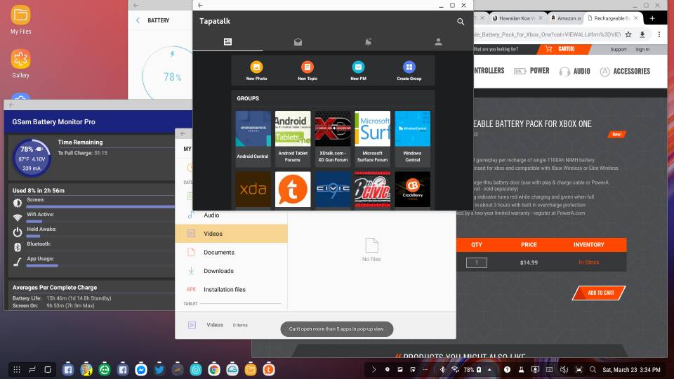

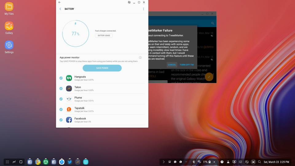

Looks like it is... Went up a percent in about 5 minutes. Not bad It is not charging fast, but I watched it go up to 79% before unhooking.
Hooked up a USB keyboard, bluetooth mouse, External 3.0 HDD and HDMI to TV.

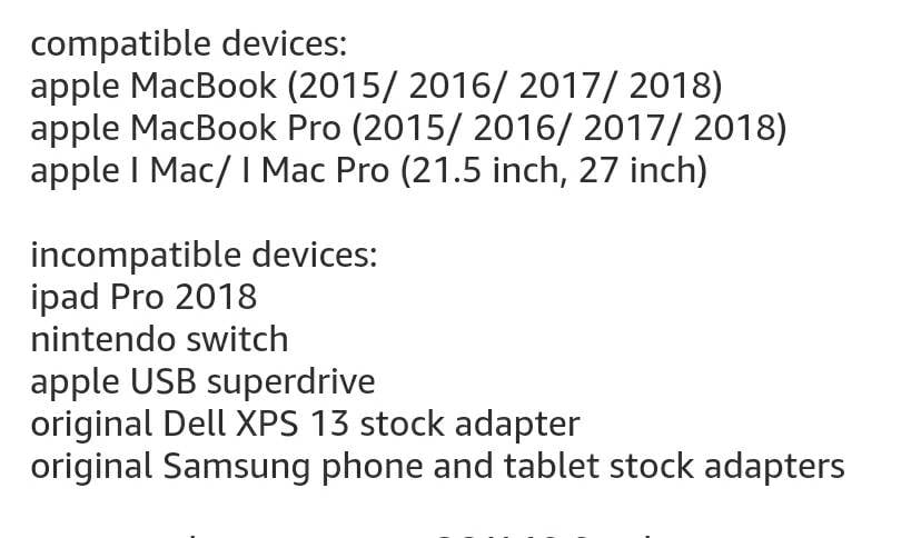

I really like Anker products and they were actually the first hubs I looked at when I started shopping for them. But on all of their listings they state that Samsung phone/tablet stock adapters aren't compatible. I'm not 100% sure what that means, but I'm guessing the adapters Sammy provides with its devices aren't compatible...maybe they don't put out enough power? That might even be the problem I'm having with my current hub.
I'm thinking that if I had a newer Macbook USB C power cable/adapter that it might work. But I'm not trying to spend that kind of money on this. I think I'll start with the same one you're currently using and go from there.

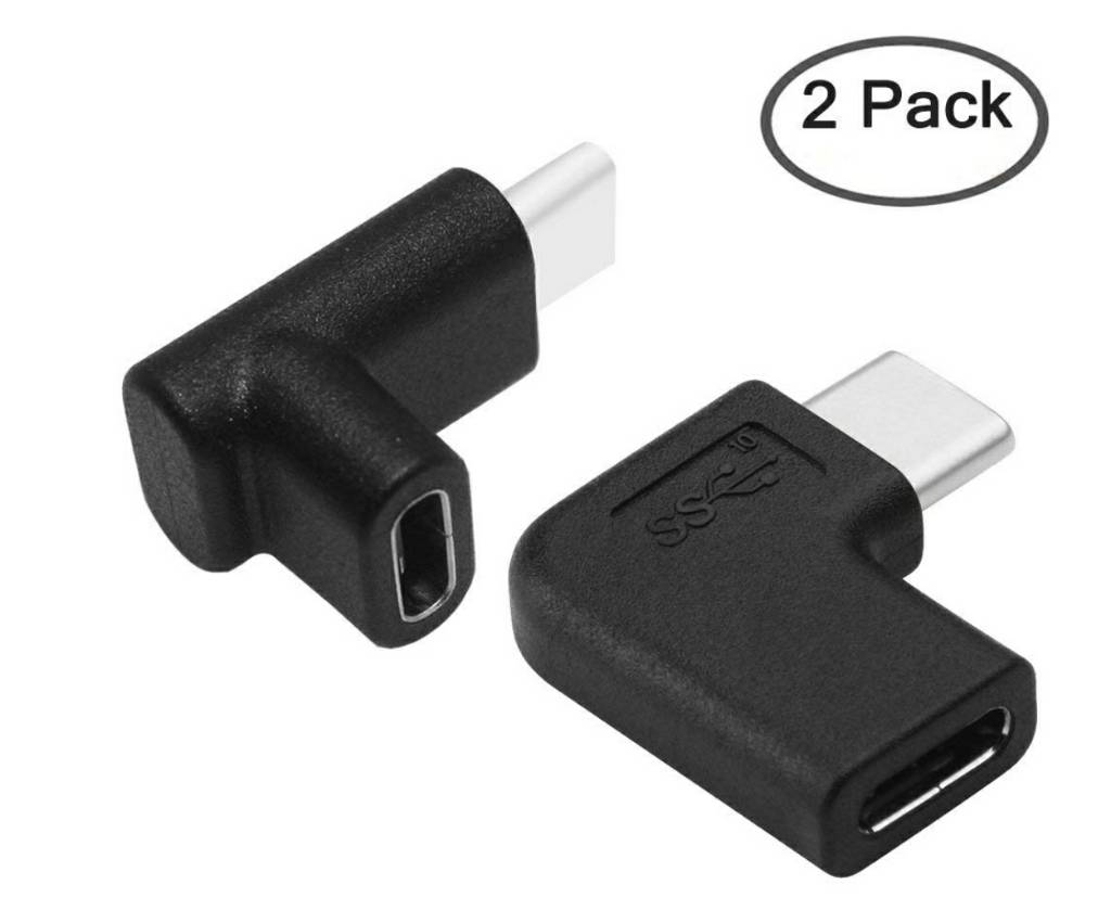

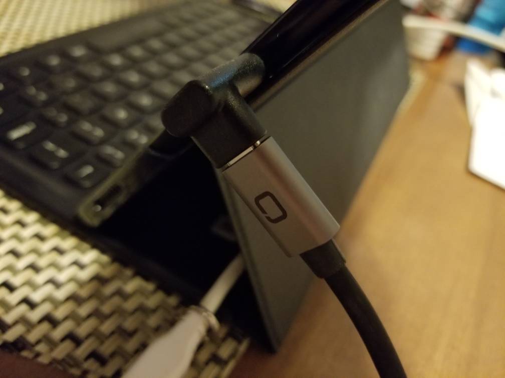

I also ordered a pair of right angle adapters. I noticed with the first hub I ordered that the cable seemed a bit on the short side and that the hub wasn't able to lay flat on a table top. I didn't like the idea of it basically pulling down at the connection point on the tablet.
https://amazon.com/gp/product/B078Y...ag=hawk-future-20&ascsubtag=UUacUvbUpU6513267
Both have a nice snug fit in the charging port on the tablet and the female end also has a nice snug fit with the hub's plug in.

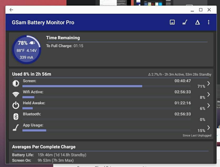

Side note: I checked out that GSam Battery Monitor app that Clint showed in one of his previous screenshots. I like it simply for the fact that it calculates remaining charging time, but it's got some really cool other features as well.

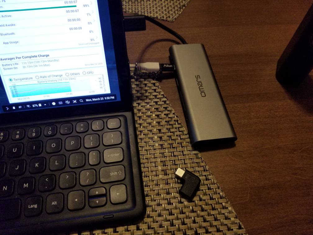

My 2nd hub arrived yesterday. It was the same Choetech that Clint is using. Using the Sammy fast charge adapter, a basic Sammy adapter, and even an iPad adapter, it was still draining my Tab S4 battery rather than charging it....which I thought was weird. Seemed well built overall though and all of the various ports worked. I preferred the size and layout of this hub over the other one I got (Omars featured in my previous post), but since charging doesn't want to work, I'm going to send it back and stick with the Omars.
That is so strange... I had it charging with my setup. Maybe your HDD pulls more power than the one I had running. That Omars one does look nice.

Now that I've been using the Omars hub for a few days now, I have noticed that there is still some battery drain on my tab if I've got multiple things plugged into the hub. It can handle an SD card or a thumb drive just fine, but if I plug my phone in to charge and also have a thumb drive or SD card in, there isn't enough juice left over to charge the tablet. I suppose that's to be expected if I'm only using the stock Sammy adapter. Thinking about buying a more powerful adapter....maybe something in the 40W range? I'm just wondering if that would be too much power when I only have a single port in use. Definitely don't want to fry the battery on this tablet.
