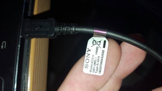

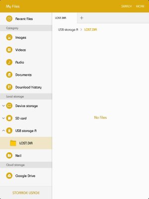

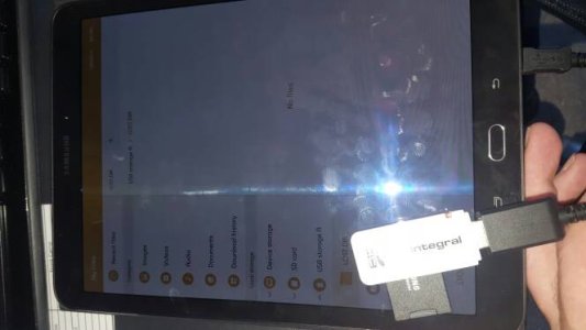

I have used otg fine with my s2 9.7, but all otg cables are not the same as there are some incompatible specifications that have been adopted over the years. Try a few other otg cables. I had one from Sony I believe that works fine, others don't. I will try to add a screenshot later of it working.
Here are some examples of what you should see. Tab S2 with Sony OTG cable, plugged in to tablet and USB card reader with sd card in (also works fine on thumb drives and hard disks), In file manager, and additional device appears in the devices connected as USB device A. Also check that thumb drive is formated as FAT.
