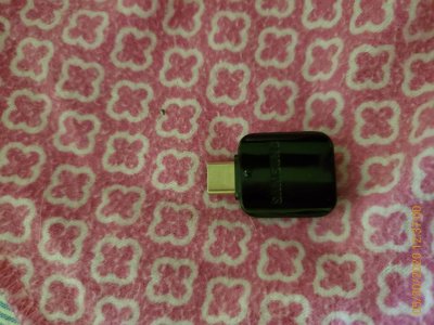

I have 2 and neither will work, wondering if they need to go in further like the charge cable. But they won't go any further, so, guess if I want one will order on Amazon and hope it fits.

This is what I'm talking about and have a white one, both are same size.

Yep definitely one in the box with the Note 10 plus 5G, just checked my box but I'm fairly sure older versions would work as well

Thanks, I thought one came with. They both connect to s8. Guess I'll try B. Diddys suggestion.
