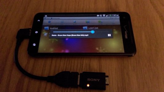

You must have a OTG cable first off, I don't believe a micro-usb standard cable would work.
Outside of that there is nothing you need to do, I've verified this on a Non Rooted AND Rooted DNA
You'll need some form of file manager, Astro / ESFile Explorer your preference.
You can have USB Debug (Developer Options) set or not set it doesn't matter
No mounting is required, but plug the flash drive in the cable, then into the phone
Check 'Storage' bottom of screen and see if it's connected.
Thanks for the info - I have an OTG cable that I ordered through Amazon, however, when I plug this cable in, nothing happens. Every now and the I will get a notification saying "unable to charge device - please use the supported charger". My flash drive doesn't light up and I'm not seeing it on my phone through the settings tab or in astro file manager. Is there a specific cable that I should be using for this or should any OTG cable do. The ones I have look exactly like the one you and others are using.
