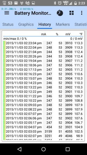

Hey dpham, what current sensor setting do you have in the battery monitor? Mine is reading the current draw properly...
