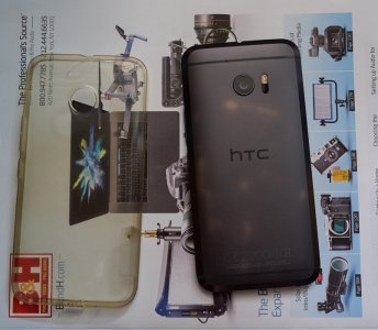

Ok I took a photo, looks like paint is gone on these spots, and it happened like overnight or I wasn't noticing it because the phone is in the TPU cover 95% of time.
Now I remember that 2 days ago I was running with the 10 in my armband and without the TPU, I was sweating 1 hour long so perhaps some sweat entered the armband's foam (neoprene) and reached the metal of the 10 and add to that the friction of jogging and running...
All I know that it's the 1st time I see paint wearing off one of my metal HTC like that after 1 year, the last time I saw paint wearing off was with the Nexus One and it was after 1 year and half without protection (so lot more sweat attack)
As you can see the tpu cover has no paint residue from the phone,pushing me into the armband theory more and more, during my winter ski days there was some condensation under the tpu cover specially under the camera area so I have no idea if there are any correlation with what happened too.
What do you think? Any tricks to restore colors or I will have to stick a dbrand skin so I can sell my 10 to get $$ and get the U 11? People here in my country are picky on average so if they see these spots they won't buy it, but a dbrand skin can make it look gorgeous again especially with a classic one like hyperblack no?
This is killing me because I was always very careful with my 10 from day 1 and now I got these horrible spots dooming my phone :(

So I passed by HTC Lebanon aka Gomobile yesterday, they checked the phone and after 10 minutes of inspection they told me that usually when there is a ''cosmetic'' problem they don't fix it under warranty THOUGH because my 10 is in perfect condition with not a single scratch or dent meaning no drops, they are convinced it's a hardware fault (paint factory fault that wear off with battery heat or other things), so they took photos of the back and sent them to HTC Middle East for a confirmation about that, knowing HTC here as they don't have the infamous machine to open closed-shell HTCs so they can change the aluminum shell, most probably they will give me a replacement. Of course this is in case HTC EMEA accept and reckon the fact that it's a paint quality fault from their side. I will have an answer in the 48h, cross fingers!!
Nice!
Good luck, please confirm what happened
Finally got an answer!
They estimated that it's indeed a paint quality fault, they want me to give them my 10 on Monday for 24h, they claimed it will be ''fixed''. Now the only way to fix that would be to open the 10 and change the whole back unless they can spray the metal like a car???
Or perhaps they are obliged to keep it with them 24h as an administrative rule from HTC EMEA before giving me a new unit.
Anyway I will RUU it this Sunday ;)
Ok it took them 24h to change the back of the 10, now it's new 100% :)
In the process they scratched my screen's spigen film, thanks God I have another one and applied it.
Though I am not sure it's due to the back cover replacement or it was there from before but I noticed like very small smudges on the screen, 3 very light grey smudges, I thought it was some dirt but it didn't went with microfiber cloth.
Dunno if I ask for a screen replacement now! The thing is that you won't notice them with any colors but white or something close to white, you can see them for example in the settings menu and even there you won't notice them with normal use, you really should search for them.
So should I ask for a screen replacement and take the risk to get a Tianma panel (mine is Sharp which is better) , get some possible scratches on the new metal back in the process and of course pay again 10$ for new Spigen films, or just forget about the smudges?
