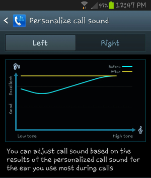

hi!
this is xena.... attached is my graph result from note2's personalized call setting?
will anyone help me out on how to interpret the results?
what does the "before and after" line graph means?
appreciate answers from experts.... thanks....:)

yup, at the call settings of note 2. just cannt figure out how to interpret the result of the "before and after " line graph.
Hi, the lower before graph line shows that you have a loss of sensitivity in the low frequencies i.e the Bass sounds.
The after line graph shows what the Note 2 will do, to amplify or boost these lower frequencies i.e Bass sounds, so that you can better hear them.

I have used this built in adjustment before with a pair of Bose QC15's, and it has worked fine letting me hear my music better using the inbuilt Note 2's music app.
Yes I have a bit of a hearing loss, and I wish other phone or audio manufactures included adjustments like this in their products. As stated before not everyones hearing is perfect.
But allowing these adjustments would go some way in better enjoying their products more.
