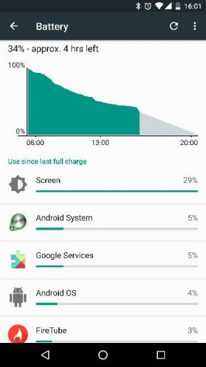

Screenshots attached. Any solutions for the battery heating issue?
Yeah. Realized that. Battery concern is not my real issue. The phone and screen heating up while charging is my main problem
Nexus 6 on Android 6
But a battery that overheats while charging could also be failing, which could lead to faster drain, so it may still be helpful to see if there's anything else to explain the faster battery drain.
