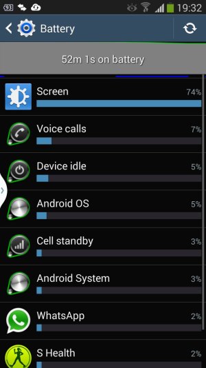

Charge fully and give it a few hours of use of the charger take a screen shot of the battery stats and let's see if anything is consuming battery that shouldn't be. If everything seems OK then it's definitely a battery issue.

This is what it looks like, an hour after i've charged it, but it usually looks like this and it lasts for about a day and a half; i think there must be something else when the fast discharge happens because when i held it in my hand the battery was really hot

Yeah, definitely a bad battery. It gets hot for whatever reason and drains extremely quick. Happened to me a couple of weeks after I got my S4. I was trying to drain the battery as fast as possible so I had the screen on full brightness, tons of apps updating and running in the background and I had the flashlight on.
