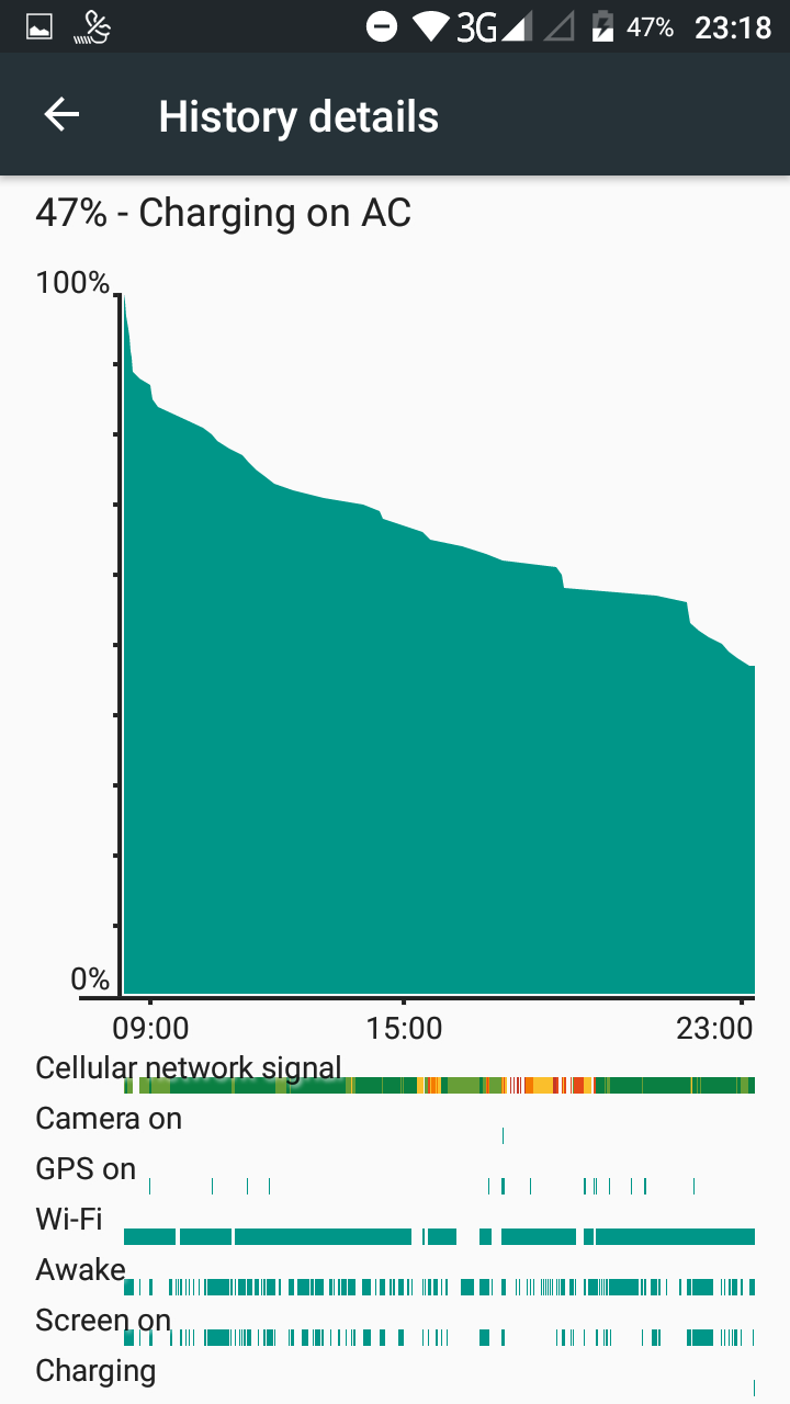

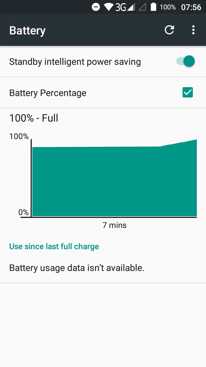

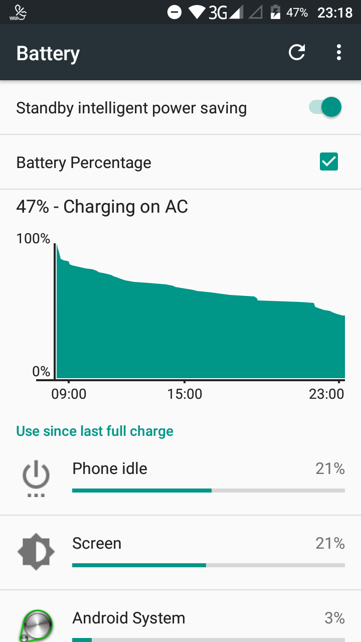

First post.......Ok battery gurus, here's my issue, got a brand new Cubot Note S 3 day ago, batt was 55% on opening, and batt behaved well as i set phone up. I charge my phone to 100 pc overnight every night. So for 3 days now upon awake(c.08.00hrs) i unplug charger, use phone a bit, check twitter, news, e mail etc, and BAM! my battery goes in to freefall! down to 95% in 5 mins, down to 90% in 12 mins down to 80% in 40 mins, nb without constant use. But then interestingly after it hits 80% ish the battery then starts to behave 'normally' and usually by 23.00hrs i have still have approx 40% left! I have more info eg screenshots if needed, also bit concerned re phone idle being a large user ...20% on one day , not that far behind the screen, never seen before on previous(moto g2)??? Im concerned that the battery is a dud and will get worse becasue what appears to be happening in my eyes is that the battery is only ever reaching 80% of life when charged, but the phone gives a 'false' reading of 100% and after I unplug it quickly readjusts itself to real value??....any thoughts/help welcome, cheers
Welcome to Android Central! Screenshots of the battery stats would still be helpful, as outlined in post #3.
It might also help to recalibrate the battery sensor software by charging to 100%, then using the phone normally until it shuts down from low battery, then charging back up to 100%.
Were you able to get the other screenshots? I noticed two deleted posts -- not sure if those were unsuccessful attempts at posting the shots.
Another thing to consider is to let the phone continue charging for about an hour after it reads 100%. This so-called "saturation charge" might help with the initial battery usage curve.
The high Phone Idle percentage makes me wonder if your cell signal is poor throughout the day. If you tap the battery graph, does it give you a fullscreen graph with a Cell Signal Strength indicator? If not, you could install GSam Battery Monitor to get that information.
The dual-SIM capability on your phone also makes me wonder if for some reason the phone might be searching for signal on the second SIM -- even if you don't have one inserted.
but second sim slot is disabled so why would it do that? the full screen battery wass the first screeshot, which has signal on it, yes signal can be poor, but why would that explain why the battery drain just changes dramatically once it goes below 80%, its chalk and cheese its as if the batt was only ever 80% like it was instructed to do that(but phone gives false read), i have heard of such things on laptops, could that be an issue Its not this Intelligent standby mode is it??? i will install Gsam and look again thansk
Whoops, sorry -- I forgot to look back in the thread for that screenshot.
Regarding the 2nd SIM slot, yes it's disabled and so it shouldn't be doing that -- but what I'm wondering is if there's some kind of firmware or hardware bug, could the phone inappropriately think it's active and therefore be expending energy looking for a signal? Just a speculation.
You've already done a couple of full charge/discharge cycles to calibrate the battery sensor software, correct?
No not quite, not done full discharge yet, I'm going to let her die tonight... Will report back in 2 or 3 days... But I suspect I'll be saying the same thing! The battery behavior may be odd(ie the first 20pc rapid drain) but it's been very consistent, again I'm left with 38% at sleep time which has been same for 3 days now, cheers for input thus far
