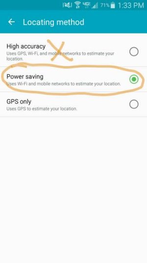

Guys, make sure u have your location Mode set to Power Save and not High. That did it for me. I've always had Power Save on kit kat. Lollipop somehow switched that to high. See attached picture
Mine defaulted to power saving mode, but turn by turn directions on Google Navigation do not work unless it is set to high accuracy, so, I set it back. I do not have this problem of it constantly searching for my location.
