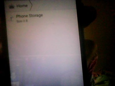

Hi guys. I have a problem here. I 'm Leagoo Z5 LTE user with Android 5.1. After I upgrade the firmware, my internal storage turned to 0 byte and my phone no longer detected SD card. When I check for storage, it showed my internal storage 8GB is full but when i checked the partition, it only showed system space which is 2GB. I dont know where other 6gb gone. Really need some help here/.

But when i go to file manager. There is no sd card folder, phone storage folder showing 0 b. When i tapped on it, it said that file format not supported. I already hard reset but it still show the same thing. Snapshot_20170128.JPG
Welcome to Android Central! How did you update the system? Was it an official over-the-air system update pushed by Leagoo, or did you download it manually from a website and install it yourself? The behavior you're describing sounds like it could be due to installing the wrong or corrupt firmware, or it could also be hardware glitch.
I think that the last update to that device was Marshmallow (it could have been Lollipop), so any recent update wasn't official. If the update was to a version of Android that uses 8GB just for itself, and the phone only has 8GB of storage, it would stop working once it got the update. (Android needs at least a few hundred MB free just to run.)
It's probably showing 0 free because there is 0 free, it's that simple. Have it reflashed to the original version of Android and it should work again.
