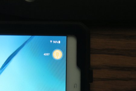

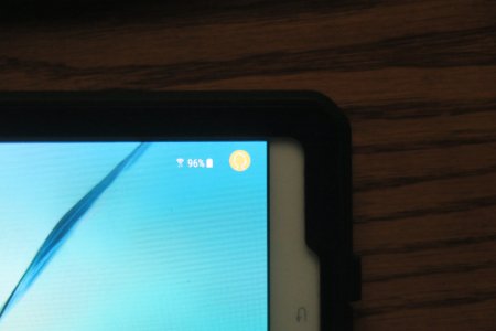

Hello I have an issue with my Samsung Galaxy Tab S2. I have searched online many times with no luck.
When the tablet is locked there is a small yellow circle on the lock screen up in the top right corner next to the battery indicator.
It has an outline of a head on it I think it is for if there is different users.
When I touch it it displays my lock screen pin number.
So any one could see it and unlock the tablet.
I can't figure out how to remove it
Thanks in advance for any help

first is with out touching and second is after touch showing the pin.
and just a reminder it is only on the lock screen

Pardon the basic question, but the name of the user profile isn't the same as the PIN, right?
check in security settings see if "Make Password visible on" is toggle on ?
Access to user profile name: swipe down, tap yellow circle, will bring up user's list, tap "you", then details below to get to edittable field where you can remove/edit the pin reference. other navigation path in is settings/user/you
19sparky82
Cool that was it!!! Thank you :D
I did that and changed the account name that was the pin
I kinda thought it had something to do with the pin being the user name but could not figure out how to get there.
Once I saw where it took me I see I can also get there from settings, Cloud and accounts, users.
Don't know how I missed that
Thanks again
A-ha! I thought it was something like that. Thanks to 19sparky82!
