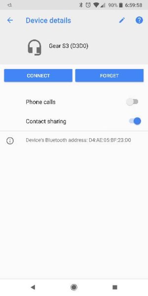

Yeah, calls don't go to phone so need to untick phone in its Bluetooth settings to be able to use it.

The Gear S3 isn't Android Wear. It's Tizen. I'm also using a Pixel 2XL and had read about similar issues with phone calls on non-Samsung phones. Because of those issues, I disabled "Phone calls" in the Bluetooth settings on my phone immediately after setting up the watch. Everything else works perfectly for me. Obviously I can't answer calls on the watch with that setting turned off, but that doesn't bother me in the slightest as I wouldn't realistically want to do that anyway.
Edit to add - I've read that Android P is supposed to address/fix this issue, but we can only hope at this point. Bluetooth on the first 2 generations of the Pixel has been less than perfect.
This fixed my nightmare so thank you. As of when I got a replacement Fossil Q Explorist (gen3) from Fossil (replaced under warranty; the first one bricked at about 3 months), all my calls were going to my watch, but only occasionally had audio - and even then - only from the watch. Most of the time after answering a call, my caller could not here me and would hang up. I didn't know about this switch; turning off "Phone Calls" made everything normal again - so thank you. Observations:
1) this problem is not specific to watch brand
2) this switch apparently can get turned on when pairing (I didn't turn it on, and I did not have this problem with the first Fossil Q Explorist watch, or with a Moto 360 Sport Gen 2 before it.
3) Even if you want the switch on (so you can answer calls from the watch), the answering behavior is broken and completely unpredictable, but mainly you can ONLY answer calls from your watch. If you try to answer calls on the phone, good chance your caller won't be able to hear you.
