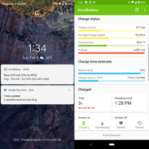

I recently got a used but excellent condition Pixel 3. I didn't realize I needed PD charger and Usb C to C cable, so I ordered this PD charger and these cables. Phone says it's charging rapidly but you can't tell me 511mA and 23.4% charge per hour is rapid charging, is it?! Also bought this charger for my car with the same results. At first I thought maybe I got some bad cables, but if it was the cables why would the phone say that it's charging rapidly? I like the phone so far outside of the battery life and need to figure out how to get it fast charging so I don't have to get rid of it. From what I've been reading I should be getting a 25% charge in ~15 minutes with PD charging and that's definitely not happening.
I recently got a used but excellent condition Pixel 3. I didn't realize I needed PD charger and Usb C to C cable, so I ordered an Aukey 18W PD charger and some Usb C cables. Phone says it's charging rapidly but you can't tell me 511mA and 23.4% charge per hour is rapid charging. Also bought an Aukey PD cig lighter port charger for my car with the same results. At first I thought maybe I got some bad cables, but if it was the cables why would the phone say that it's charging rapidly? I like the phone so far outside of the battery life and need to figure out how to get it fast charging so I don't have to get rid of it. From what I've been reading I should be getting a 25% charge in ~15 minutes with PD charging and that's definitely not happening. Would it be worth trying actual Google charger and cable or are there other issues here?

Alright I drained it until about 50% or so and did get better charging rate. I saw the charge go as high as 2000mA and about 50% charge per hour. This is faster but still not as fast as I was expecting. Really kinda sucks that the charging slows down like that once it starts getting closer to 100%. If I'm in a jam I'd want it to get full charge as fast as possible. Can anybody else tell me what % per hour you get on your Pixel 3?

I blasted out the port good with my air compressor. I just don't really see why the battery drains so fast. Took the phone off charger for 15 mins before going to work and it's already down 2% just being idle. My last phone Samsung J7 had 3300mah battery with larger screen and battery lasts 3 times as long as this.
The phone is designed to take maximum of 18w of charging, nothing more. IIRC, USB-C PD charging for the phone is using 9volt when rapid charging. So, 2Amp @ 9 Volt is 18w. It slows down automatically when above 90% to protect your battery life.

Ok so I drained battery all the way down to 6% and did see that it fast charged up until 70%, so I'm looking at about 65% charge per hour. I guess I'll just have to get used to eating up the batter on this thing. I'm the kinda person that freaks out when my battery is lower than 80%, ha. Thanks for the help guys.
