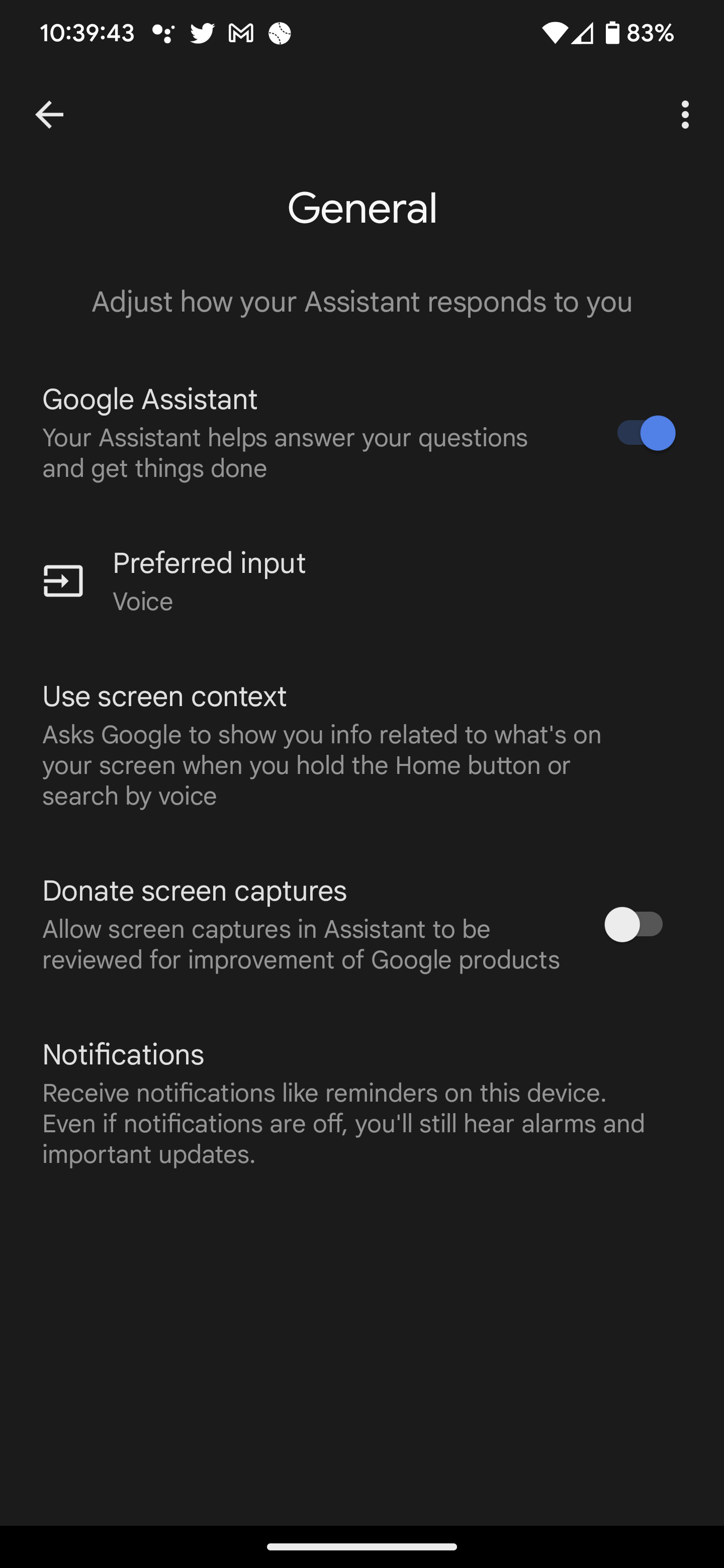

Did you double check the assistant settings on the general and check below for voice
Everything looks to be in order. Input voice works it6s just that the assistant is talking.
Thanks for the suggestion though.

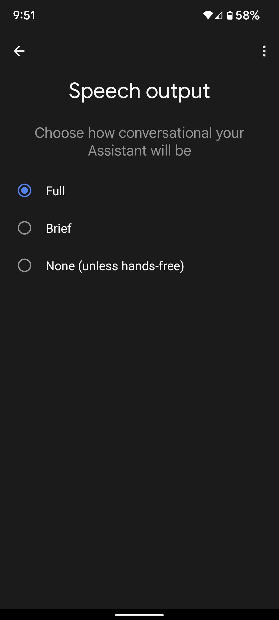

Look for assistant settings. Scroll down to assistant voice and sounds. Should be 3 settings to choose from there.
Weird. If she asks a general question (Hey Google, do you like me) it will vocally respond. If it is a specific question like "what's the temperature here" it will show the temp but without vocals.
Well then, short of the factory reset or uninstalling all updates and data in the Google app then reinstalling. I'm at a loss. Personally, I would start with the Google app.
