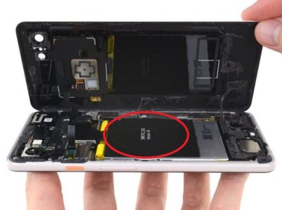

For reference with regards to the charging coil location, it is nearly perfectly centered on both models.
Here's exactly where the coil is on the 3 XL (image taken from ifixit.com, red highlight added):
and on the 3 (image from JerryRigEverything):
NOw back to the search for the 'golden' solution...
