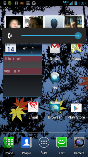

Hey everyone,
I have been having issues with my Bionic ever since the upgrade to ICS including the touchscreen going non-responsive, battery drain (yes, I keep the usual battery drain suspects off, and I use Task Killer), inability to answer calls. However, the newest quirk my Bionic has been displaying, the proverbial straw, has got me thinking wistfully of getting a different phone. Perhaps you fine people can help me fix this. It has been displaying garbage in the widgets instead of text. At least right now it's displaying text for the app shortcuts, but at times everything is garbage. I was able to accomplish that after a soft reset, power cycle and battery removal.

Could you post a screenshot?
Here are a couple of screenshots. All widgets are displaying this behavior with text, and as I said before sometimes the app shortcuts do the same thing.

Did you try a factory reset? I know it sucks, but it helped my phone a lot.
Sent from my DROID BIONIC using Tapatalk 2
+1 and then some. Agreed that it sucks, but ICS is so different from Gingerbread behind the scenes that doing the ota and then adding all that info created on the old os just creates problems. Best to start over - clean.
Also, ditch that Task Killer. You're doing more harm then good. ICS is pretty efficient in managing itself, by you killing tasks you are fighting the OS. Just because it shows up in the task killer list doesn't mean it's truly running or draining power, just means it's in a ready state as the OS thinks it might need something from it in the near future.
Does this only happen on widgets?
