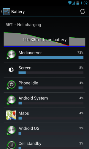

Please Help: "Mediaserver" is draining my battery. Solutions?

That does not work, My Mediaserver battery usage is at 81%. And disabling Google Now is like getting an Iphone 5 and disabling SIRI......After trying literally EVERY suggestion online i managed to get it down from 81% to 73%. I see people on here complaining about 15% pffft...........
