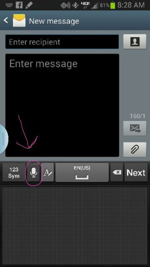

Does it look like this? If so, does it only happen when type pen is out?
Sent from the AWESOME Note 2 of a girl :)

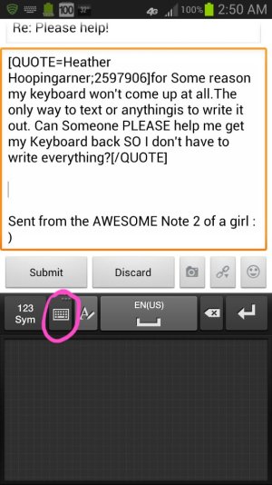

Perfectly stated above. I had the same thing happen to me and the very kind forum members helped me. As long as you have Pen detection turned on..... The keyboard will come up that way every time. I leave mine on and when I go to write any type of message I just click/hold down the 'Mic' button and there select the 'keyboard'.
Margie
Sent from my Galaxy Note 2
I have a keyboard icon and not a mic icon.

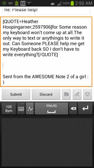

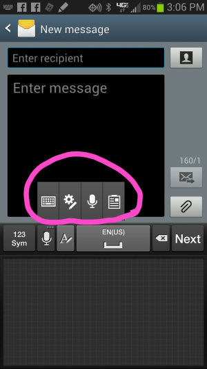

Hmmmm, that's interesting! When I have S Pen turned on and S Pen pulled out of phone and go to type a message (email, text etc) the screen looks like the pic I posted above. When I click and hold down the mic it gives me 4 options to select. I click on picture of keyboard...and then the full keyboard fills that bottom portion.
