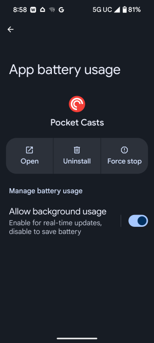

Vexing issue with m P8Pro. This just started yesterday. I was using BeyondPod (yes, I know it's no longer in the app store) and my podcast paused for no reason. I restarted it. It kept stopping at random intervals. When I went looking for the developer is when I found out it is no longer around. I thought, well, I'll change to another podcast player and installed PocketCasts. Set it all up and started using it last night. All worked well. Now, PocketCasts is pausing st like BeyondPod was. Randomly. As I sit here typing this my podcast has paused, and from time to time starts playing again for about a second and then pauses again...it has done this several times. I checked and the app has "Allow background usage" turned on. I have no battery saving settings turned on. Frustrating as hell, especially now that I surmise that the problem is in the phone and not the player since it has done this with two different player on different podcasts. Does anyone have any ideas? I saw the thread about youtube pausing and I need to look at that thread again because it mentioned an app to install that can tell you about system events and such as they happen.

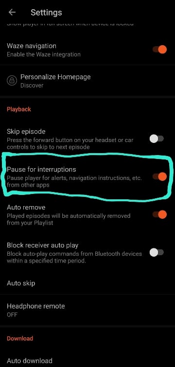

I've used PocketCasts, and I remember there was a setting I had to change to help the app from being closed. This was in the settings for this app. Could this help?
