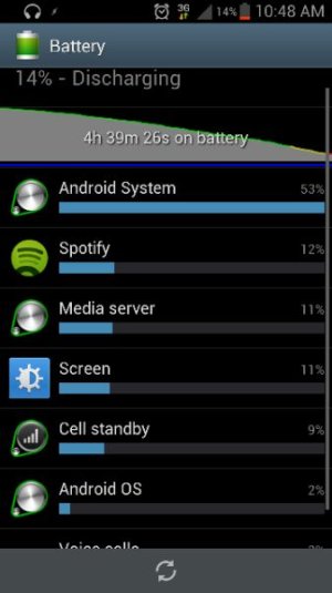

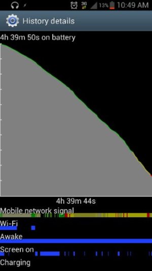

So I've been hearing all these great things about the battery life on the GSIII lasting 14+ hours...I'd like to know how. I unplug my phone at 6am and I'm usually at 30% by 12pm. During this time I'm listening to music on player pro or listening to cached music on Spotify. I try to keep the screen off as well. I don't get great signal at work, so I try to keep it in airplane mode, but sometimes I forget and it goes on/off roaming, signal searching, and 1 or 2 bars.
Attached are my most recent battery stats. I did everything I mentioned above plus made 2 short phone calls (< 30 minutes). Why such battery drain? Is there a fix for this? I'm rooted with no rom, so I can flash something if it will help.

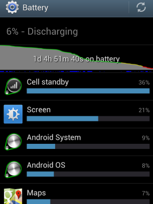

Here is proof that great battery life is achievable. I still had about 6% left and I was well over 28 hours of running time. It looks like your biggest culprit is the poor network signal.

If you check your second pic, you can see that the phone was awake the whole time, even when the screen was off. That there is the drain. Something running in the background.
Id blame it on Spotify, as you say you were using it the whole day.
Spotify definitely does this. It keeps the phone awake even when screen is locked. Slacker wakes the phone when needed but it doesn't keep it Perma awake.

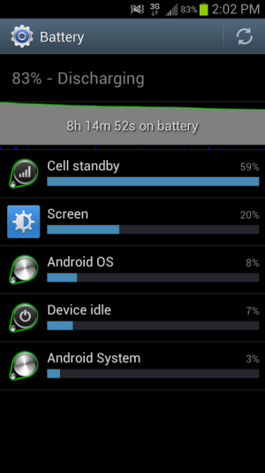

And this is my battery graph after removing some bloat and that gsiff_daemon process that was keeping my phone awake.

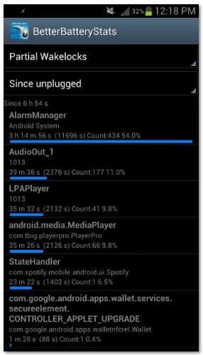

I actually found out about BetterBatteryStats last night and I started it up this morning when I unplugged my phone. This is what I found:
(And my battery did much better today, as you can see in the screen shot. I didn't do anything different except that I didn't listen to Spotify this morning.)
I looked up what "AlarmManager" was and according to a thread on xda, it can be caused by weather apps or other constant sync apps. So I checked a weather app. I just downloaded, and sure enough, it set itself to sync ever 30 minutes. So I stopped that right away. I also fixed some of my Tasker profiles, since some of them didn't have an exit task and were still running based on state (ie headphones plugged in). I also uninstalled light flow. I'm not sure if it was causing problems, but the people on xda weren't too fond of it. I'll see how much better it does when I start fresh tomorrow, but so far it's been helpful!
