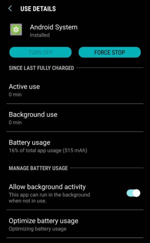

I have noticed that Android System uses a lot of my battery, while my battery life drops like a rock while I have my screen on. I never have my screen brightness passed 25% (and it is usually less).

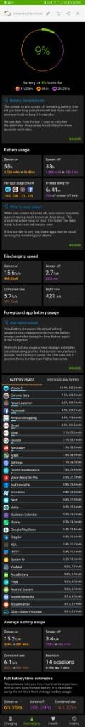

Please take a look at these screenshots. What is going wrong?20181223_081424.jpeg20181223_081455.jpeg20181223_081516.jpeg
The 6% Phone Idle and 4% Cell Standby would make me wonder about poor cell signal, which can really eat up battery. Install GSam Battery Monitor to get a better idea of what your cell signal strength is like throughout the day. If it's mostly moderate-to-poor, then that's probably the main culprit.

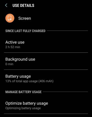

When not using my phone, my battery only dropped about 2% per hour, which is great. But when my screen was on, I seemed to have lost a lot of power. I can't even get 4 hours of screen on time.

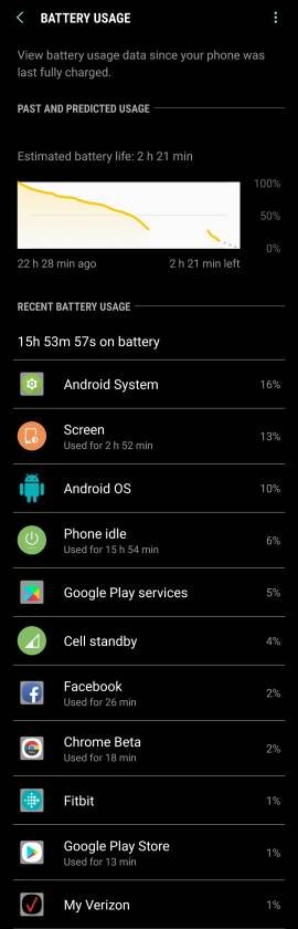

What would cause tis to happen? I barely have my screen brightness at 20%.Screenshot_20181226-212620_Settings_1.jpegScreenshot_20181226-212642_AccuBattery_1.jpegScreenshot_20181226-212709_AccuBattery.jpegScreenshot_20181226-212721_AccuBattery_1.jpeg
Hi, I merged your threads. I still think poor cell signal is part of your problem, considering that the cell signal indicator in that screenshot shows only 1-2 bars, and you still have fairly high Phone Idle and Cell Standby numbers. Is there any way you can test out the battery performance for a whole battery charge when you're in an area with good cell signal?
