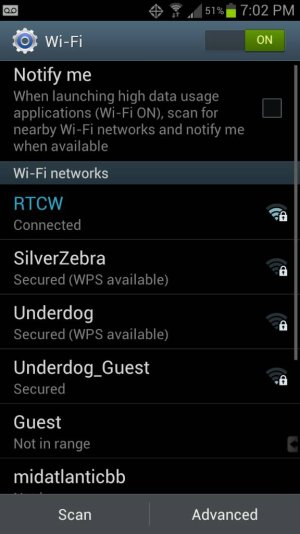

So, your phones can see the router just fine (4 or 5 bars?) but when you attempt to connect you don't get a connection? Or you get a connection but suddenly it's only 1 bar? Or it connects and then drops the connection? For reference, here's what my Settings -> WiFi page looks like:uploadfromtaptalk1349488975843.jpg
Sent from my rooted, debloated, deodexed Sinclair ZX-80 running CM -0.001 using Tapatalk 2
