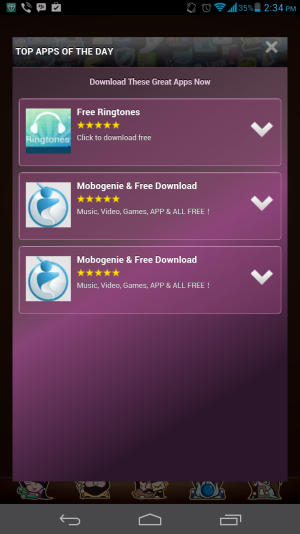

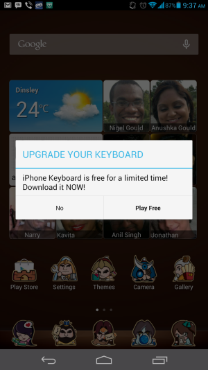

Hey all, I recently started getting this issue as well, but after running the outlined apps to check for pop ups I found that none of them are causing the pop ups.
I got some screenshots of the pop ups though:
Does anyone have any ideas?
