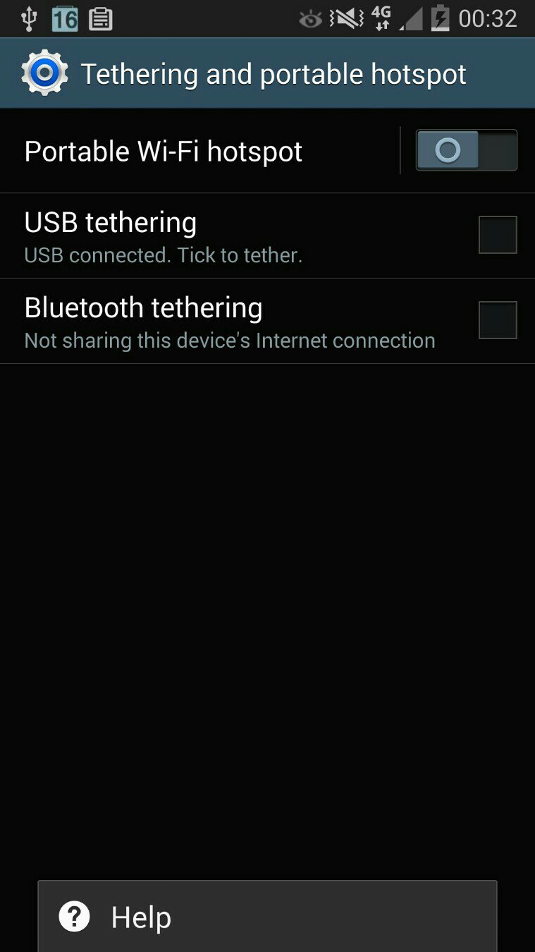

I have started tethering in the last few days with a new plan.
Via wifi, or usb from a charging port, to my Lenovo W7 laptop mainly.
I have to reconnect every 20 - 30 minutes as it switches off in Settings. Probably more so on usb.
This can't be normal?
Sent from my SM-N9005 using Tapatalk Pro
It doesn't seem right to me. I only tether via wifi on my Nexus 7, but never have problems with it timing out. Is the timeout on the phone or lappy?
Thanks. The switch on the phone wifi tethering setting turns off and I have to turn it back on when I see on my 'lappy' that connection is lost. I only used it via wifi the 1st few days and I didn't give it much thought if I saw it happen a couple of times (short sessions).
Via usb it started happening during longer sessions.
It may be my lappy. I have since uninstalled and deleted previous network connections on the pc, inc sim data wifi dongles.
Sometimes when tethered via usb it shows a wired connection symbol, other times a wifi symbol.

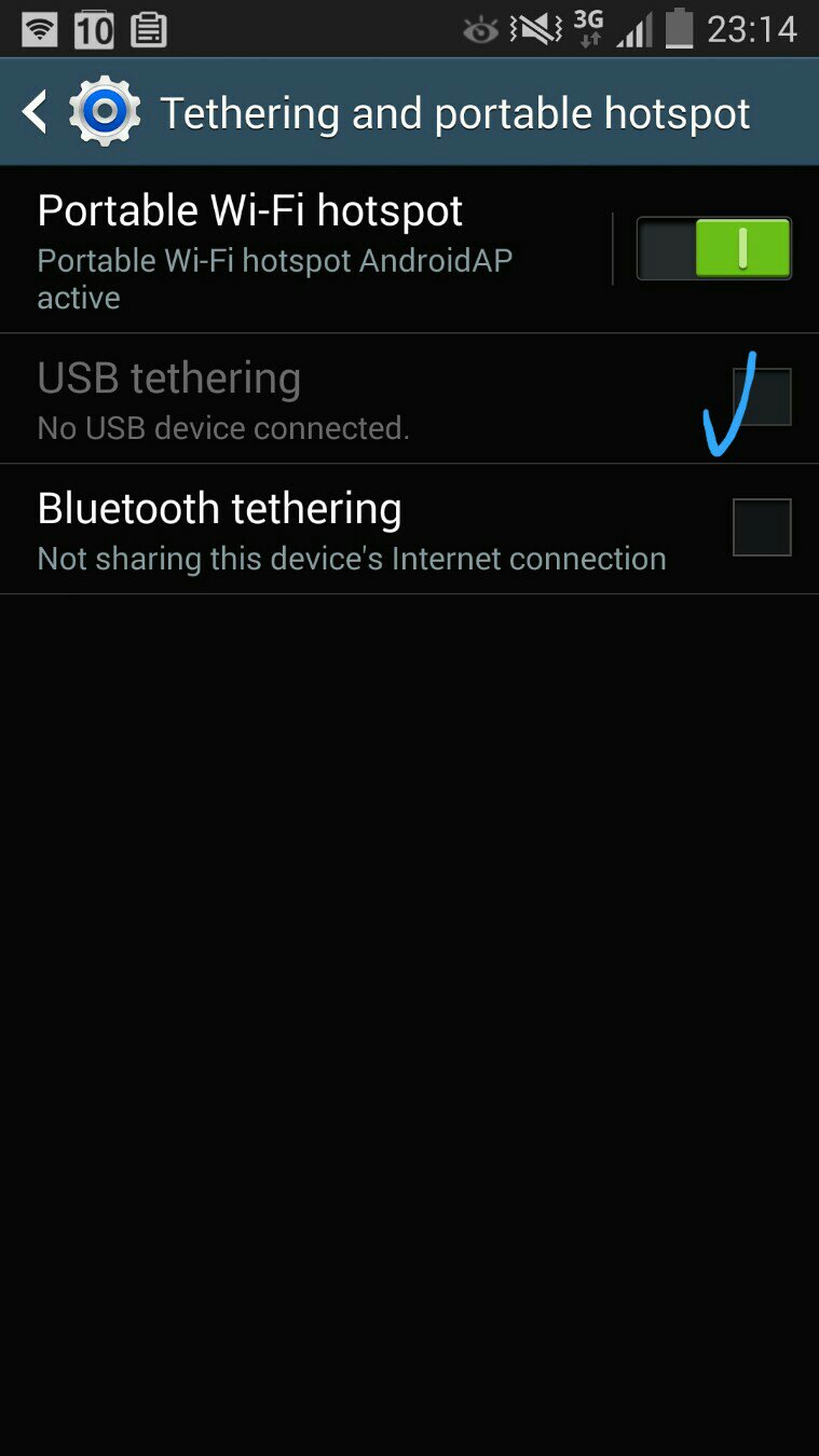

Also the lappy has 1 of 4 usb ports designated for charging and I had used that in the past with data and wifi dongles. It may be causing a problem having the phone charging as well. I haven't had time to try other ports, but overnight I left the phone hotspot switch on with the laptop off and it stayed switched on.
I will give it some more trials or look at the pc network settings or reset them.
So it shouldn't happen.

Hi. I was gonna say no, but there are some frequency bands? instead of Auto in advanced settings. I have it hooked up now to a different spare usb port. It's showing as a wifi connection on the pc, sometimes its the wired symbol.

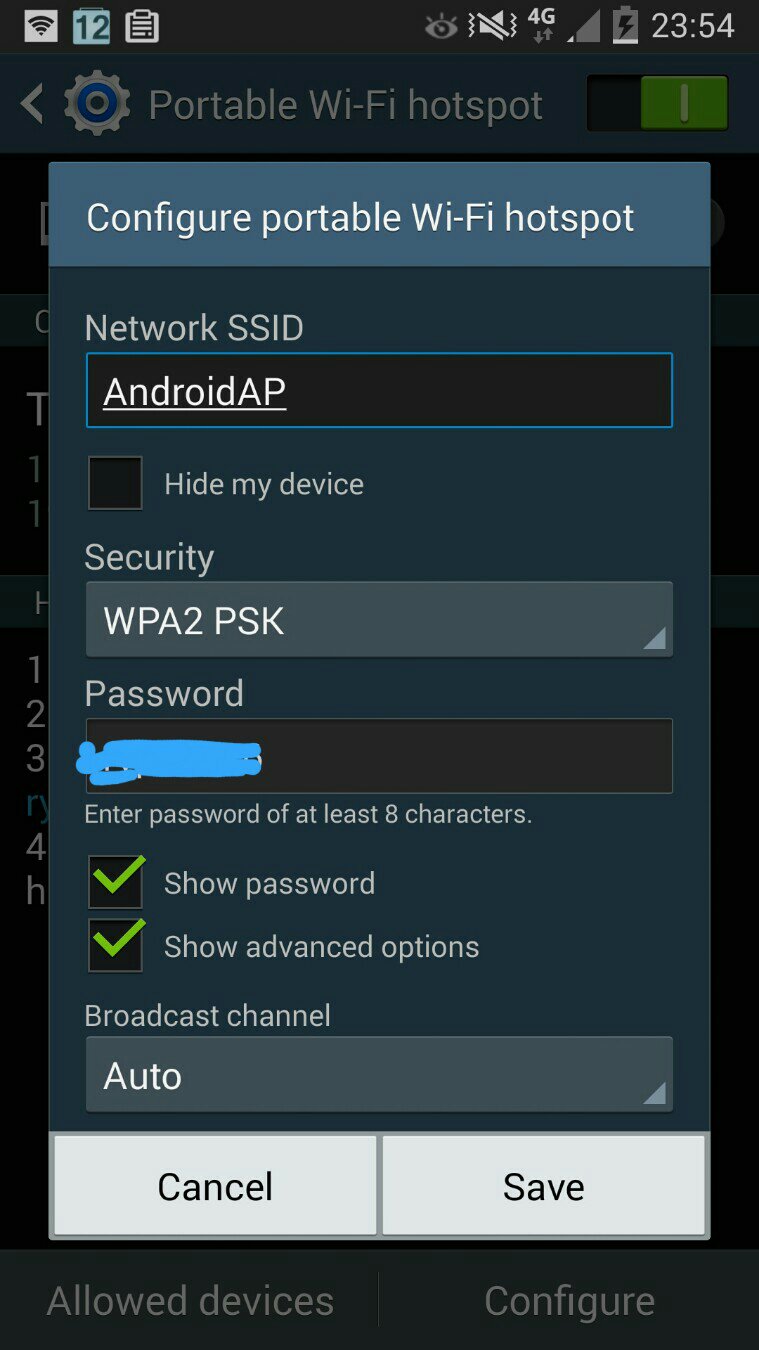

Time for screenshots, there's always time for screenshots.
You know I was just giving you an excuse to post more screenshots since it makes you happy.
Do you have anything show up if you press the menu key when in the hotspot settings? Try both with the hotspot on and with it off. There used to be advanced settings somewhere with a timeout. (not talking about used to on the Note 3 but android in general).
Btw, on my TMO hotspot, the timeout is listed when you check the Show Advanced Options box like you have in your screenshot above. Do you have a timeout option there below the Broadcast channel if you scroll down or is that the end of your advanced options?

Sadly no on that. Just a 'Help' box when on or off.
Also, think about whether you have any settings or apps that are set to save either power or data by turning off either mobile data or wifi after a certain period. Or if you have any app that will force the wifi to connect to the internet for syncing or some other reason.
Missed this. No, there is nothing available below the auto shaded box thing.
