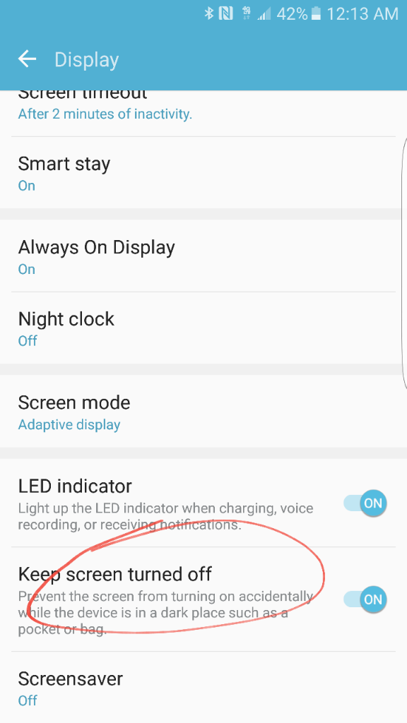

The only thing I can think of is this setting may be effecting it.
Didn't even notice that setting was there. It was turned off by default. I turned it on today and still the same problem twice.
