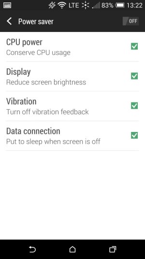

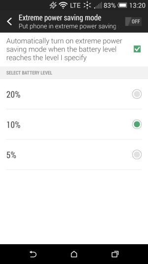

As you know the "Extreme Power Saver Mode" allows you so set a threshold trigger of 5%, 10%, or 20%
I can't figure out how to do something similar for the normal (not "extreme") "Power Saver Mode". What I'd really like to do is set the phone to enable "Power Saver Mode" at around 60% battery.
I'm quite adept at Tasker but I can't seem to find any API to toggle "Power Saver Mode" on/off

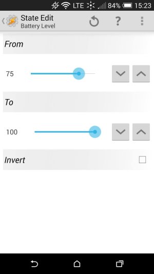

Step 1
Create a batter level profile. I created one for 75-100%

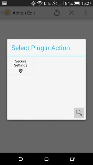

Step 2
Add Action select Plugins (this is where you need the secure settings plugin)

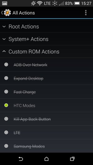

Step 3
Select "HTC Models" from Custom ROM Actions
Step 4
Power Save Mode Disable (For my profile I want it disabled at 75-100%)

Forgot to say Part 2 is you need to set a lower Battery Profile 0-74% with Battery Saver On
So that's 2 profiles one for 0-74 and another for 75-100
There's probably a way to do them all in the same profile but this works.
