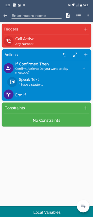

Another option might be Macrodroid. I created and tested the following macro, and it works. It uses the existing TTS (text-to-speech) engine already in your phone, and will use its voice. You can adjust speed and pitch independently within the macro. However, it will use the voice you have configured in your TTS settings. If you have more than one TTS engine installed, it will allow you to choose which you want. The one downside to this method is that there is no trigger for "Call answered." The choices are "Call Incoming" and "Call Active." In my example below, I use Call Active, and have it generate a pop-up message asking if i want to play the message. If YES, then it plays; if NO or no response, it will time out after 30 seconds and end the macro (timeout timer is settable).

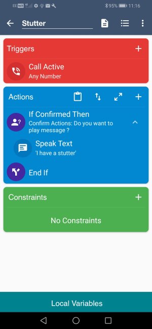

That is really great, I have created the macro and the pop up appears when a call is made.
I am trying to resolve a couple of things.
The TTS "speaks" but only through the Android speakers, the caller on the other end does not hear the message yet.
I am also trying to make the "pop-up" permanent so that I can invoke the macro at any time.
On installing MacroDroid it noticed I had a Huawei phone and said I could have problems but seems OK!
Oh, I forgot the thing about where the audio plays. Go into Settings and select "Voice Call" (note that this is a global setting).
Re making the pop-up permanent, that won't be possible. Macrodroid works on the concept of "triggers" (i.e., an instantaneous event). You can have multiple triggers (treated as 'OR') but not permanent ones.

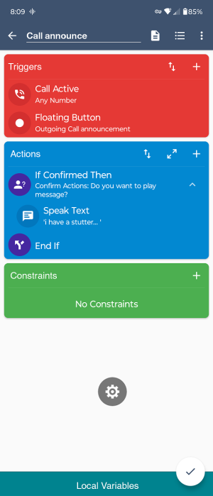

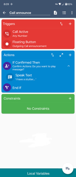

With the benefit of a 2nd cup of coffee, I realized it is possible to fulfill your request for a permanent pop-up (sort of). It won't be a pop-up, but it may be better. That is, use the "floating button" feature. As the name implies, it will create a button that floats onscreen (any screen), which can be used as an alternate trigger. The button can be any size/shape/color/transparency you want, with any icon (on your device) desired. Note that the button (and thus its functionality) is not visible until you save the macro. So initially, it will look like this:
After saving, it should look something like this:
At this point, either trigger, an active call or tapping the button, will cause the audio to play. Thus, in the case of the popup being generated by an active call, you still have to either answer NO to the popup or ignore it until it times out. Two things come to mind to avoid this becoming a PITA.
  1. Set a very short timeout timer on the popup.
  2. Depend entirely upon the button and remove the popup by deleting or disabling the 'Call Active' trigger and the 'If Confirmed Then' leaving only the Floating Button trigger and Speak text action.
It might be possible to keep both triggers without them getting in the way of each other by adding an OR or XOR clause to the existing "If Confirmed" loop, but I'll need more coffee to figure that one! Let me know if you'd like to investigate that possibility.

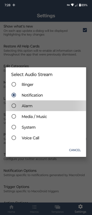

This period of silence is due to me playing catchup! I have now got the Floating Button working but I am struggling with the "Select Audio Stream" bit.

Tap the Settings option (gear icon) in the lower-right corner of the app. Scroll down to "Play Sound Audio Stream" and you'll see it.
Finally got it working. The TTS message can now be played at will. I have noticed that I need the volume turned up high for this message to be heard on the receiving phone, so perhaps this works by audio coupling between the speaker and the microphone.
