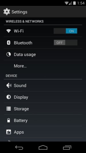

But which cached data? Everything? My instructions were for the cache and data in download manager only. Granted, i am running stock Android and not a Samsung with Touchwiz, but there still should be a way to clear specific apps.
All Android phones are not setup the same across manufacturers; hence, your instructions were not correct for the SIII
since your menu chain does not exist. The OP asked for specific instructions for a specific phone; not a generalization.
As well, the "Download Manager" is accessed differently in the new menu chain for the Samsung SIII [Android v4.3]... it
is as follows.
  • Settings
  • "More" Tab
  • Applications Manager
  • Slide menu to "ALL"
  • Select "Download Manager" from app list
From here, you can then do a "Clear data" and "Clear cache" for the device.
I have done this from here this time and will post once again if the files are downloaded again.
