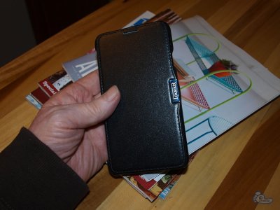

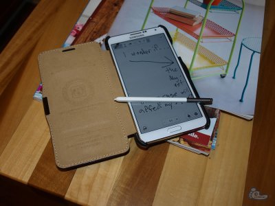

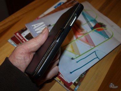

After reading so much about the problem of magnetic cases I worried about finding a decent case for my Note3. I ordered one case that had no magnet and found it very difficult to remove the phone from the case when I needed to mount the phone on a stand for the work I do. I watched and read a lot of reviews and looked at a lot of phone cases. I saw far too many that looked like women's clutches. I may be what some refer to as metrosexual, but I definitely lean toward a more masculine style. A guy in hick country can't be too careful, ya know.
I found a handsome looking case made by I-CARER, but it had a magnet. The literature from the manufacturer assured me there was no problem with this magnetized closure. I ordered it. When it arrived, I could see that the magnetism of the closure was pretty weak and was mounted on the very edge of the case, separated by a barrier of leather (or something). I never had any of the problems I read about, but I did even further testing from what I read in this discussion. You can see, after having used this case for over a month now, what affect it has had on my S-Pen: none.
I love this case. The phone comes out easy when I need it too, the corners, face and back are well protected and it don't make me look like a sissy-boy. ;)
Jim
