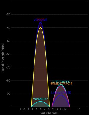

Security is set exactly as you suggested. I installed WiFi Analyzer. Of course, I did not understand what it showed. I will try to attach the saved image. It's a bit complicated.

It looks like your router is using the same channel as that other one in blue (which I can't read). Channels 1-3 are not in use, so try changing the wi-fi channel in the router settings to one of those.
I'm back online again. Many house guests kept me away from my computer to provide a timely response. The two identical wifi peaks are 2805 (my wifi) and Xfinity (Comcast). I changed to channel 3. Both peaks moved to channel 3, again right on top of each other. Comcast is my ISP and when connecting to wifi I always get a choice between those 2. I don't know what security comes with XfinityWifi but there is no little lock on its icon so I always choose my own wifi. The channel selection is automatic unless I choose manual. Today Wifi analyzer has both peaks at 10.

The Xifinitywifi peak is coming from your router. With Comcast, every home router will broadcast a public xfinitywireless hotspot that anyone else who has a Comcast account can log into. It is completely separate from your network, and is not supposed to pose any privacy or security risk to you. But here's how you can disable it, if you want: https://customer.xfinity.com/help-and-support/internet/disable-xfinity-wifi-home-hotspot/
