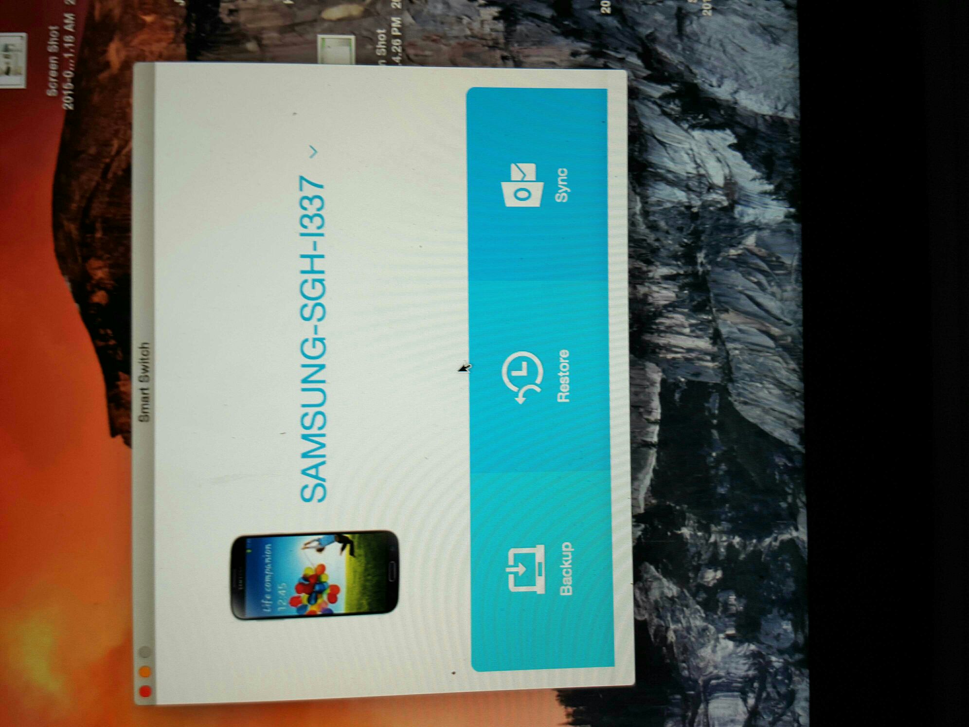

Yuppers. Download Samsung Smart Switch for MAC. You can update it via the MAC rather than OTA.

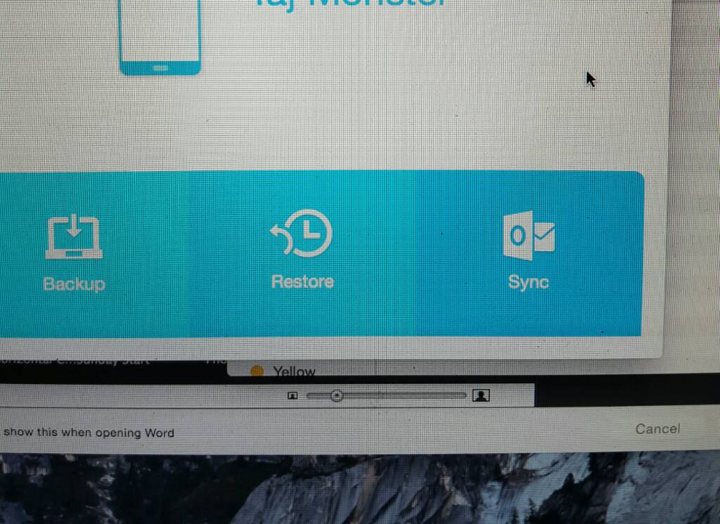

What's the next step? I'm not trying to transfer my phone to this one, I want to use this phone for a separate purpose.

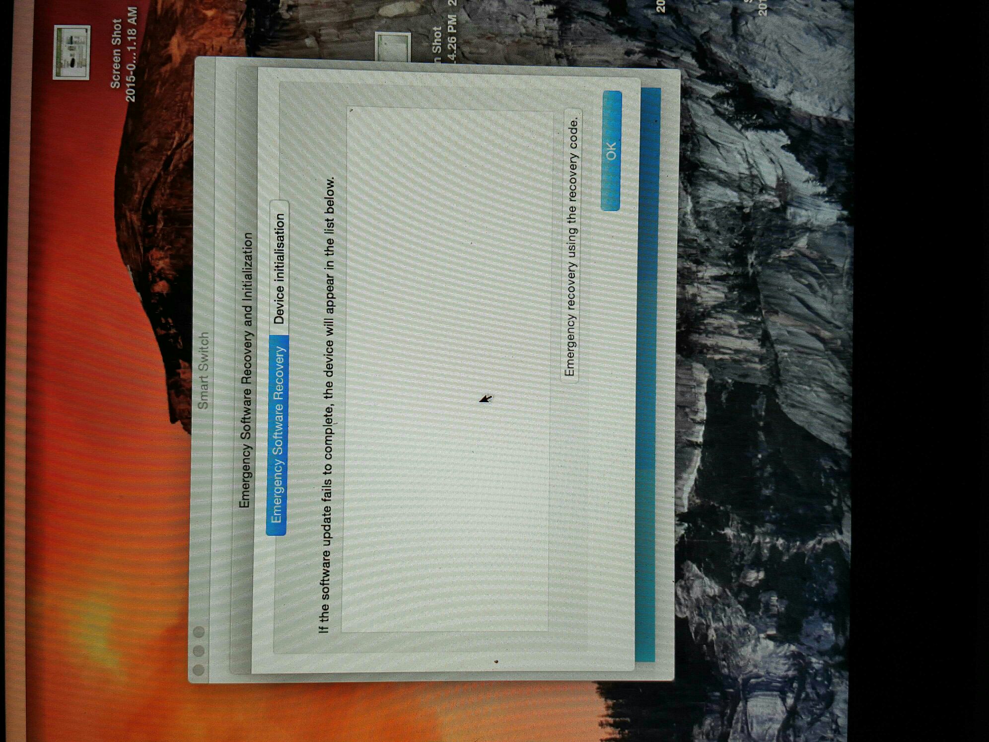

Thanks but nothing seems to happen when I tried that. I don't get the "update software" option and when I go to emergency software recovery, my device doesn't show up at all

You cannot update AT&T devices using Kies or Smart Switch. Their updates are only available OTA for those on the AT&T network
That explains it, Good to know, I am Canadian and all providers here allow it.
