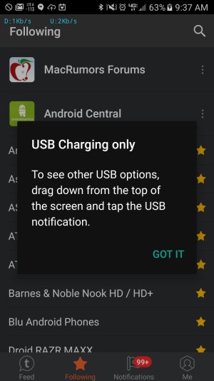

The first time you plug it into a pc, you should have seen this message.
That message only comes on the very first time you plug into the computer. You can verify by doing a factory data reset if you wanted to but it would be pointless. I wouldn't worry unless you are having problems
