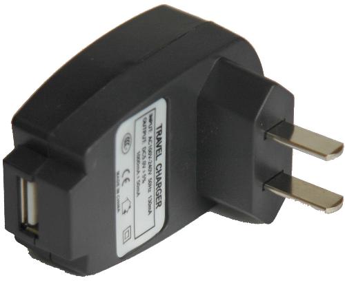

Exactly. I realize my computer USB port only puts out a small charge. But I want a cord that can plug into the USB AC/wall unit I have:
or the USB DC car charger I hvae:
