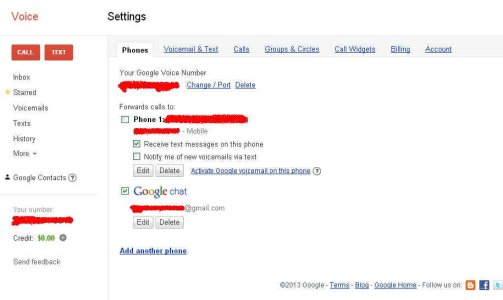

It sounds like you have calls forwarded to both Google Chat and to your cell number. If you forward calls to only one location in your Google Voice account you'll only get one incoming ring. So if you forward only to Google Chat then only GrooVe IP will receive the call.

I had Google Voice (desktop browser) forwarding calls to my carrier network #.....so that's why it was ringing both dialers intermittently. So if I answered via the stock dialer I was using my minutes even though whomever called my gVoice number. WHAT A DUMBARSE!! Haha.

Make sure you don't have call forwarding checked. Now that I don't, only my GIP dialer rings when my gVoice # is called.

That's a pretty darned cool tip! I just changed my GV settings; it should be interesting to see how well this works out.
I am still testing the lite version, so I need my GV number forwarded to both for now (so I can, you know, answer calls while I am out ;)), but that sure sounds like the solution.
I just had one of my co-workers call me (I hadn't yet received any phone calls since adjusting the forwarding setting in GV) and it seems to work perfectly.
