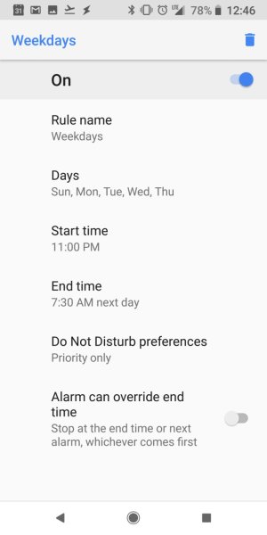

I set my do not disturb for weekdays from 11pm to 7:30am. After 7:30am it still shows do not disturb is on. I have to manually turn it off. Is this normal? Does anyone use this and have the same issue? It's not a huge deal but kind of annoying.

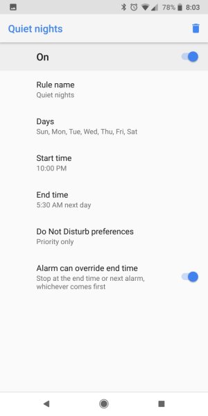

What do your settings look like? And, where did you set it up?
In Settings -> Sound -> Do Not Disturb preferences, I have configured "Quiet Nights" which looks like this:
It turns itself off at 5:30 AM, as expected. Pixel 2 XL.

Here is my setup. But at 7:30am, it does not turn off. I have to manually turn it off. I do not have the alarm setting turned on because sometimes, I snooze and don't want to be bothered. Screenshot_20171109-124606.jpgScreenshot_20171109-124559.jpg

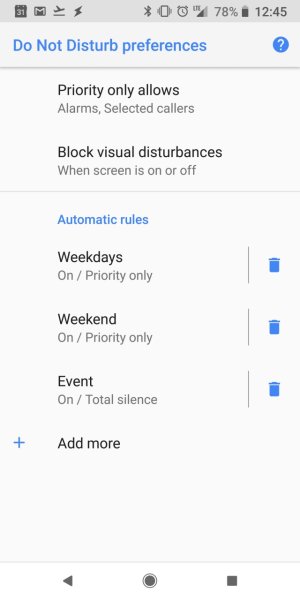

Can you check the settings of your Event rule?
Maybe there is something there that would explain the problem.
Should automatically turn off. Could always use an app like Tasker to toggle DND.
Event this is for meetings, but it was happening before I added that. Doesn't work for event rule at all.

You realize that Event rule is turned on in that screen cap, right?
I'm not sure what your issue is, the scheduled DND works fine on my phone. Maybe a troubleshooting step you could try is to delete all rules and start from scratch. See what happens...
I think what he meant is that even though the Event rule is enabled, his phone is not automatically going into DND during scheduled meetings.

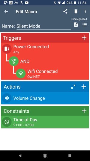

I use MacroDroid to achieve silent mode. MacroDroid is a free app which allows you to build macros. When my phone is charging AND on my home wifi AND it's between 9pm and 7am it is silent. When taken off charge it goes into normal mode. I found this better because some nights I'm out and about so a schedule just based on the time of day and day of the week just wouldn't work.
Normal mode is achieved with another macro:
Triggers: Power Disconnected
Actions: Volume Change
Constraints: None

I prefer MacroDroid because for me, as a non-programmer, it is easier to understand. Prior to the Google fix for the ticking sound I had MacroDroid turn off NFC during a call and turn it back on afterwards. I was very pleased with myself, lol!
