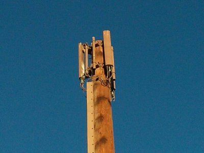

Take a shot of the top of the tower where the antennas are. Home - American Tower Home - American Tower
Most towers in the US are owned by a large company called American Tower. Very few towers are owned by the actual carriers them selves. This is why you see many sets of antennas on 1 tower. If you look up, each horizontal plane will have a triangle shaped spread of antennas.. Usually 6-9 antennas on each horizontal plane, separated by about 10 feet vertically. Each triangle set of antennas is for 1 carrier. If this one has leasing info for metro PCS it probably has legacy CDMA and metro LTE on it. Im not 100% sure if Metro LTE is accessible by TMO phones that are LTE enabled. In theory it can be but not sure the work has been done on the network side to enable it. The CDMA side will never be accessed by a TMO phone. TMO is GSM/LTE or technically GSM/EDGE/HSDPA/HSDPA+/LTE (LTE only if you have an LTE enabled phone.) More then likely this tower will not help you but with out knowing what they are actually implementing inside its hard to say, especially with the two companies now being 1. They might put CDMA on it and LTE thats accessible to both Metro and TMO users.

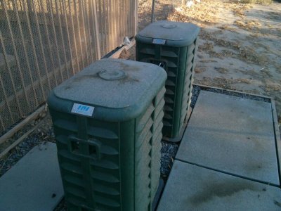

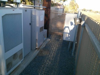

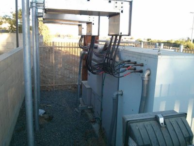

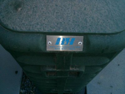

Here's a bunch of pics I took today.
I'm amazed at how realtively unprotected all that expensive equipment is. Seems like both people or animals could get at it pretty easy!
Its only expensive to the carriers who buy it.
Someone stealing it and taking it to a pawn shop wont get jack. Since there isnt a black market for stuff like that lazy criminals dont target it.
I also think many criminals dont even know what is inside many of those boxes.

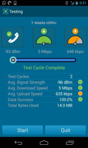

Here is what I'm getting in room where previously I'd get 2 or no bars.

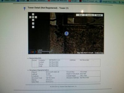

That's pretty good I think originally the op mentioned it was a metro pcs tower looks like it's a t-mobile tower instead
Where did the info come from?
Sent from my HTC One using Tapatalk 2
The site is called antenna search. You can find out who uses the towers in your area.
Who said anything about criminals stealing it? i was thinking more in terms of animals or kids getting in there and damaging something. And as it being only expensive to the carriers who buy it, um....you realize that it is ultimately all of us as customers who pays for all this equipment, right?

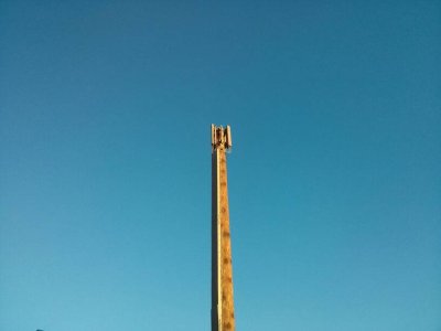

Based on the pics this is a double first for me.
My first first is the fact its on a wooden telephone pole. Ive never seen that type of configuration. Usually its a steel mono pole or other type of higher up framing system.
My second first is how small the fence is around it. All the towers ive seen have 8-10 ft chain link fence and most have barbed wire around them. A few of them ive also seen a camera mounted on or around them to watch them.
Im going out on a limb but perhaps this is in a smaller suburb or city with a relatively low crime rate or borderline rural and the need for more security is lower, also the telephone pole configuration will provide less height above ground level and thus less overall coverage. Unless its on top of a hill thats the shortest tower i have seen.
I think it has something to do with regulations here in California. All of our cell towers are about this height. Most like your said are on metal polls though but some are on wooden polls too. Some of them are even disguised to look like palm trees.
