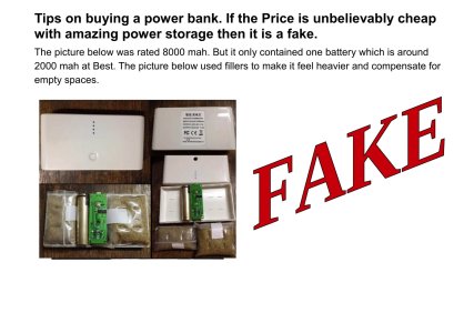

Buying and carrying spare batteries of every device is not a practical option either. (Not to mention the extra expense over time.) So you need to have a portable power bank of your own from which you can charge the batteries of gadgets properly, or break down on you. i recommend not going for the cheapest option. This is one of times where you do indeed get what you pay for.
There are 3 ways they make fake capacity powerbanks. One, is the picture with the high end sandbag. Two, they actually put batteries with cement inside. And the third one, They label or advertise or sell the charger at a much higher capacity than it actually has.
About F-a-k-e-b-a-y POWERBANKS
Fake 50,000mAh ~= 25x AA size rechargeable battery (assuming 2,000mAh - 2200mAh each per battery).Now, picture the size of a single AA battery and multiply by 25. Then picture how the size of the chassis should be.If they use li-polymer and if it is even close to being a real capacity, several manufacturers we have spoken to believe that this 50000mah capacity is way too high and your phone could explode. So, Many of them are also fake.Stay away from these.I have seen 150000mah as well. Ridiclous!
